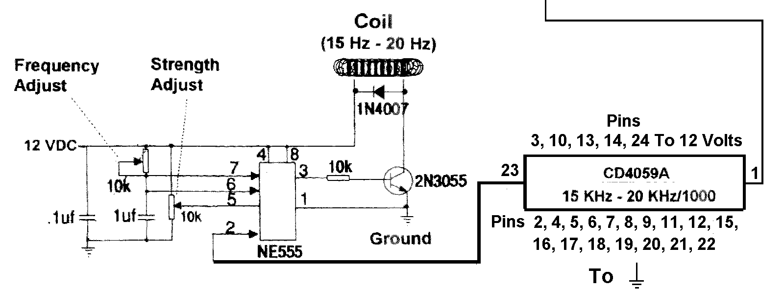

If any one is familiar with the CD4059A Divide by N chip (programable counter)
i would very much appreciate your help as i don't understand the manufactures data sheets, i need to divide by 1000.
If any one could help with actual pin connections to derive at this factor it would be fantastic as i have come to a halt with my latest project.
("From: support@ti.com
Tie pin 24,10,13 and 14 to power. 15V
tie pin 1 to clock 20Khz
the output will come out on pin 23. 20Hz
Tie all other pins to gnd.
The input clock signal must swing lower than 4.5V and higher than 10.5V in order for the part to see it.")

CD4059A setup
Hi everyone,
I found this on the internet on how to program CD4059A for N = 1000
I have enclosed the GIF picture.
Enjoy,
Johnny

My input clock reads 8.8v from pin 3 of NTE955M. What do I have to do to get it to swing?
CD4059 pin 1 input
The instructions say about pin 1 on CD4059 - tie pin 1 to clock 20Khz.
On the hydrostar circuit where would I connect the cd4059 pin 1 that would supply 20Khz?
Any info on this circuit would be gratefully received as is seems to me to be a piece of S...
The LM741 does not work. I have replaced it with a simple dc voltage reducer. Not hooked up the power yet because of the problem of not knowing where to connect the CD4059. Maybe the whole thing will go up in smoke!!!
Anyway, connecting up the CD4059 is my last step before switching on.
