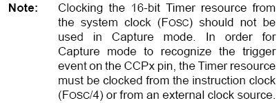

You are using the dedicated internal 32KHz clock for TMR1 source, right?
movlw    0xbe     ;tmr1 prescaler /8 and TMR1 off,
movwf    T1CON        ;and 32khz clk
While bit 3 allows that for TMR1 operation, will it work with capture mode? The datasheet seems to say that mode must use the instruction clock or and external oscillator:
A simple test might be to set your system clock slower, say 250 KHz, use the instruction clock from that for TMR1, and test whether TMR1 counts are then transferred to the capture registers.
