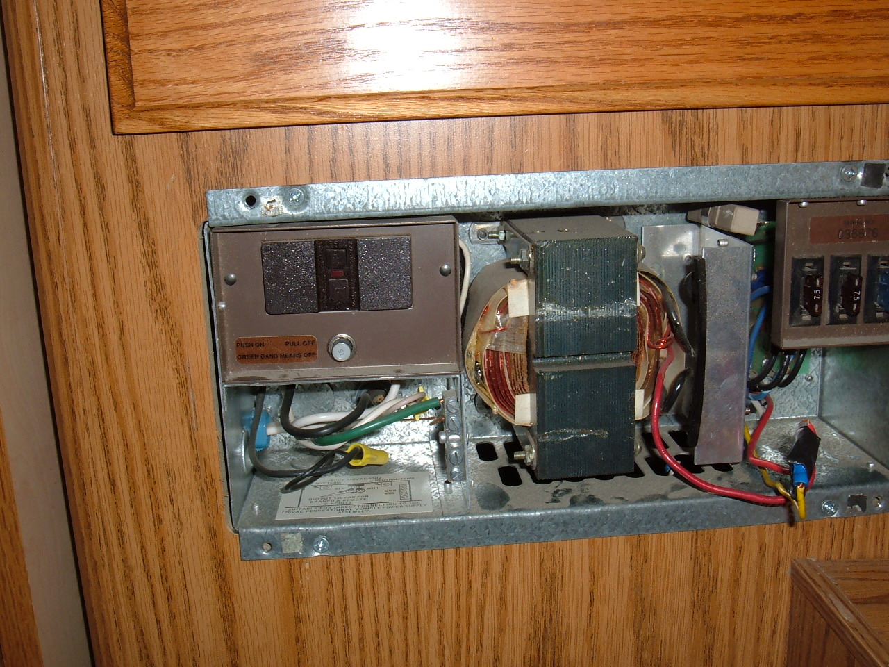

The wiring in my inverter has become slightly disconnected. I have red wires coming from the 1) inverter and 2) external battery that when connected separately to the yellow wire will power the lights in the pop-up camper. The inverter is supposed to charge the battery in addition to powering the lights. The wiring diagram on Pg 5 of the attachment (upper right corner) looks like I should connect the two red wires with the load wire. However, there is something in between that I don't understand where two sets of numbers 1 and 2 are. Carson is not in business any longer. I took some photos but alas, my daughter "misplaced" the USB cable.

I appologize for the quality, but here is a photo of the inverter showing the red wire coming from the inverter winding on the left, the yellow load wire, and the red wire coming from the battery on the right. When plugged into 110 V power supply the wire from the inverter will power the lights. Separately, the wire from the battery will also power the lights. Does connecting the three wires together make sense? When the inverter is connected to 110V, it would power the lights and charge the battery. If it is not connected to 110V, the battery would power the lights?

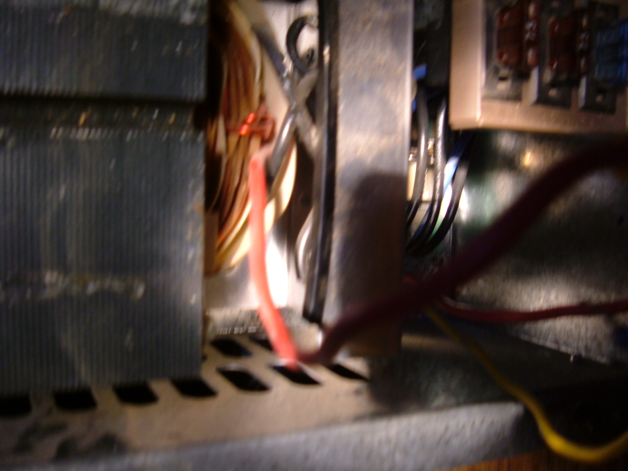

Goldenoldie.. Can you hit the macro (flower button on the camera). Or rest your elbows on something. The picture is blurred bad.
Better photos
Here are some better photos. Out of curiosity, I did connect the two red wires (this is shown in the photo - the red wire on the left from the inverter, the red wire on the right from the battery and the yellow load wire). The fuse to battery blew, so I guess that eliminates that option.

Well, my first thought. You have the manual page with the wire hook-up.
Take a DVM (digital volt meter) and see what you have on the wires. You should find 12 volts DC easy with the DC VOLT meter. Label them them (normally -black and +red).
Now disconnect the power input and the battery, and with nothing powered, short an AC outlet and you can find the AC outputs (loads) with the OHM meter.
Guessing the AC input it intacted. Was the input wire pulled to? If so short it and on OHMS find them.

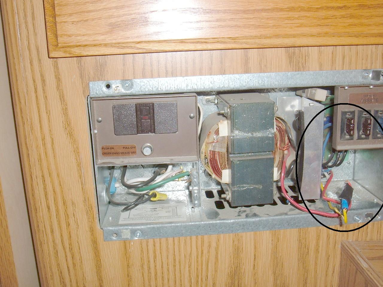

Can you take a clear picture of the area circled below, but slightly from the right and below, so we can see the connections to the battery charger board?
The funny symbols labeled 1 and 2 are the contacts for relay 1 and relay 2. The new picture may help identify where your wires connect.

Now, your problem.
You have by-passed the relay contacts by shorting the red wires.
The mystery yellow wire needs to be traced back, looks like an add on. Perhaps ground from the bat? hard to see from the pics. If it is power to a device then make sure it's connected to the load side of a fuse.
There appears to be empty spade connectors on the board
  • the red wire from the transfo needs to get to the board (the common point of the open contacts)
  • the other red wire (from the bat?) also also needs to get to the board (the common point of the closed contacts)
Hard to see from the pics, but make sure you have a box clamp or a protective guard on the hole where the wires come in the back of that unit on the right, to protect from the sharp edges cutting into your bat wire. A clamp can be seen on the left side for the incoming AC
Since someone has been yanking out wires, to avoid any nasty surprises or unneccessary light shows, I would also verify that all the wires agree with the wiring schematic that you have there, before you give it another flash test

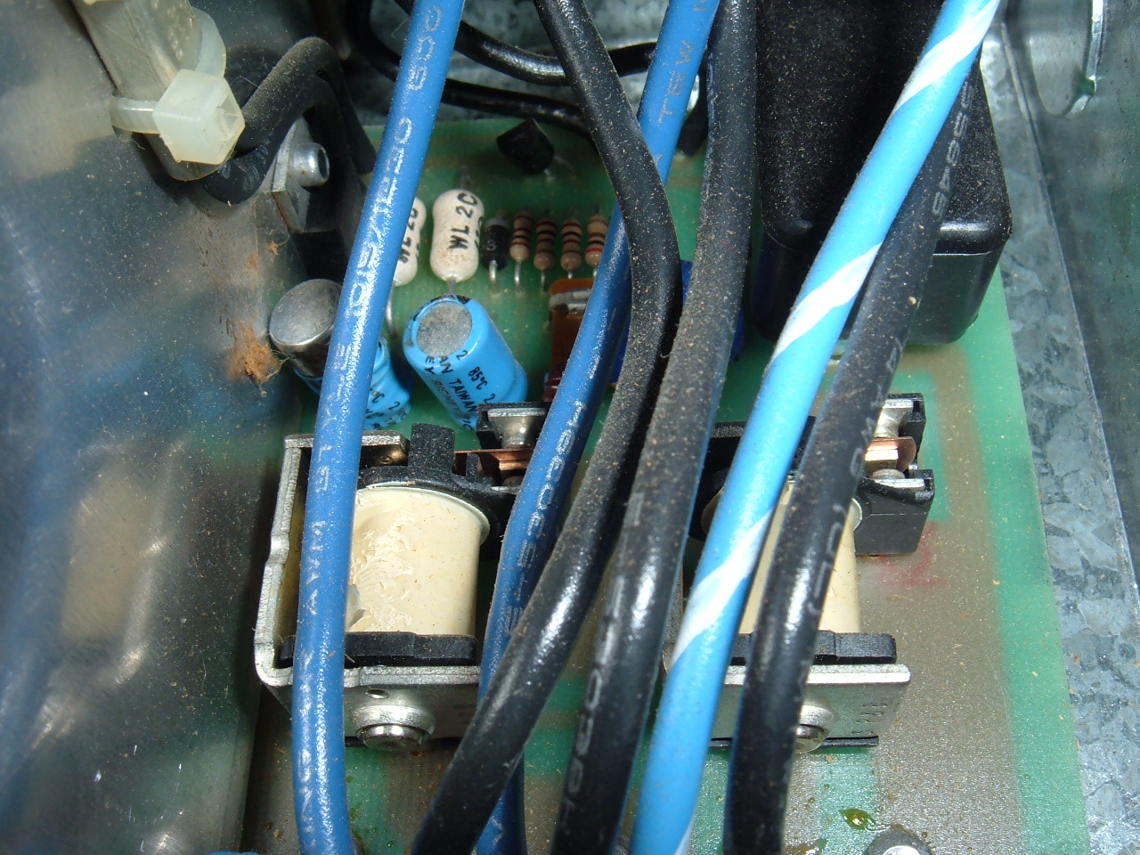

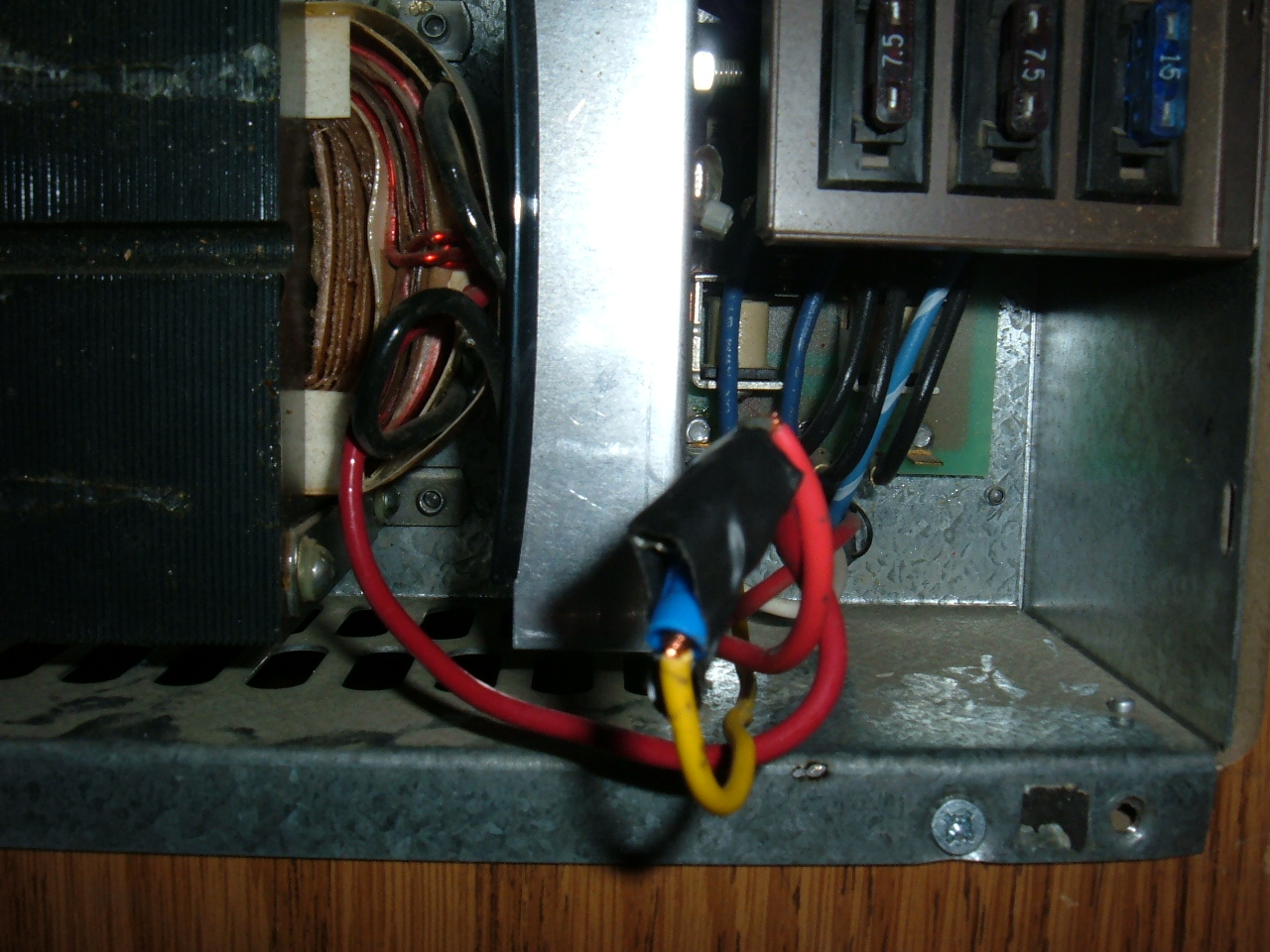

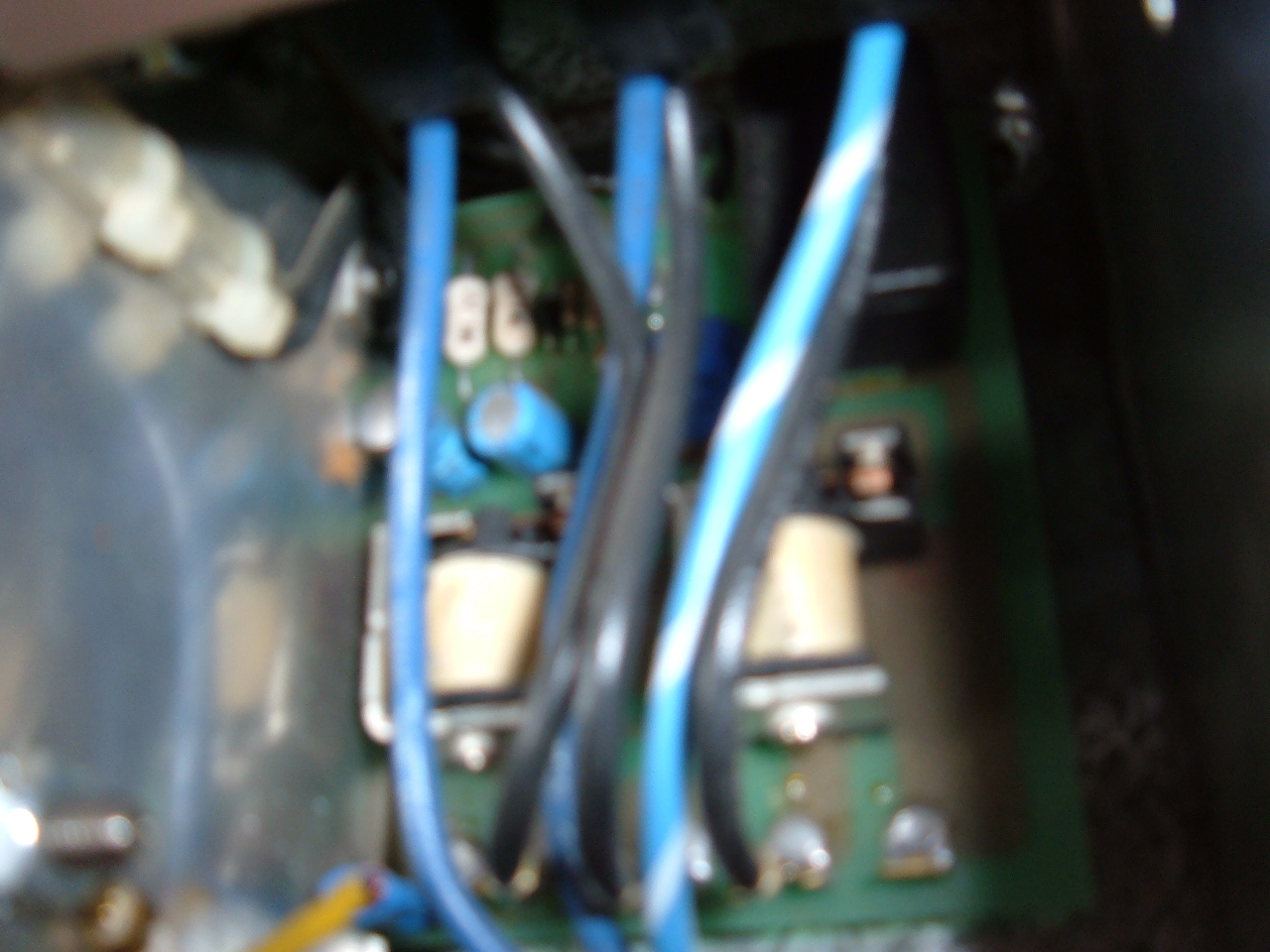

New Photos
Photo 3 is not real clear but shows the yellow wire on the left spade. Photo 4is just above the spades. There are three black wires on the middle three spades and as pfofit noted the right spade is empty. The black wires go into the fuse sockets, the blue/blue&white wires come out of the fuse sockets and presumably go to the loads.
I shorted an outlet (with neither ac or dc connected) and have continuity with the black wires connect to the spades and ground.
Comparing the parts list from the manual and the converter, I can't find the relay (part labeled "8"). Am I missing something? Could this be why the wiring was altered?
Should I disconnect the yellow wire, put the converter red wire in it's place, and connect the red wire from the battery to the empty spade?

Part #8 looks like relay K1 in the "ac component" section looks like behind the brown panel on the upper left with the 15 amp push in breaker.
I do not know or can tell for sure from the pictures. You must check the circuit board and trace those spades back, from the foil on the board to see where/what they go to. You may have to pull the board to see the back if you cannot trace the foil from the top with a good light. It looks like the spade on the far right goes up to an open contact on one of the relays, but I'm not sure
From my last post
From your second picture of your last post, a capacitor has its jacket melted and looks like it may be close to touching the heat sink for the diodes. The exposed cap case looks like it belongs to the filter for the charger or zener reference in the charger and may be common ground as well as the sink.
Nevertheless, you need to determine if this may be due to heat from the sink or a defective cap overheating. Also what is that yellow stuff stuck on the sink next to the cap. Did that cap rupture and spew its guts or is it dust of some sort
