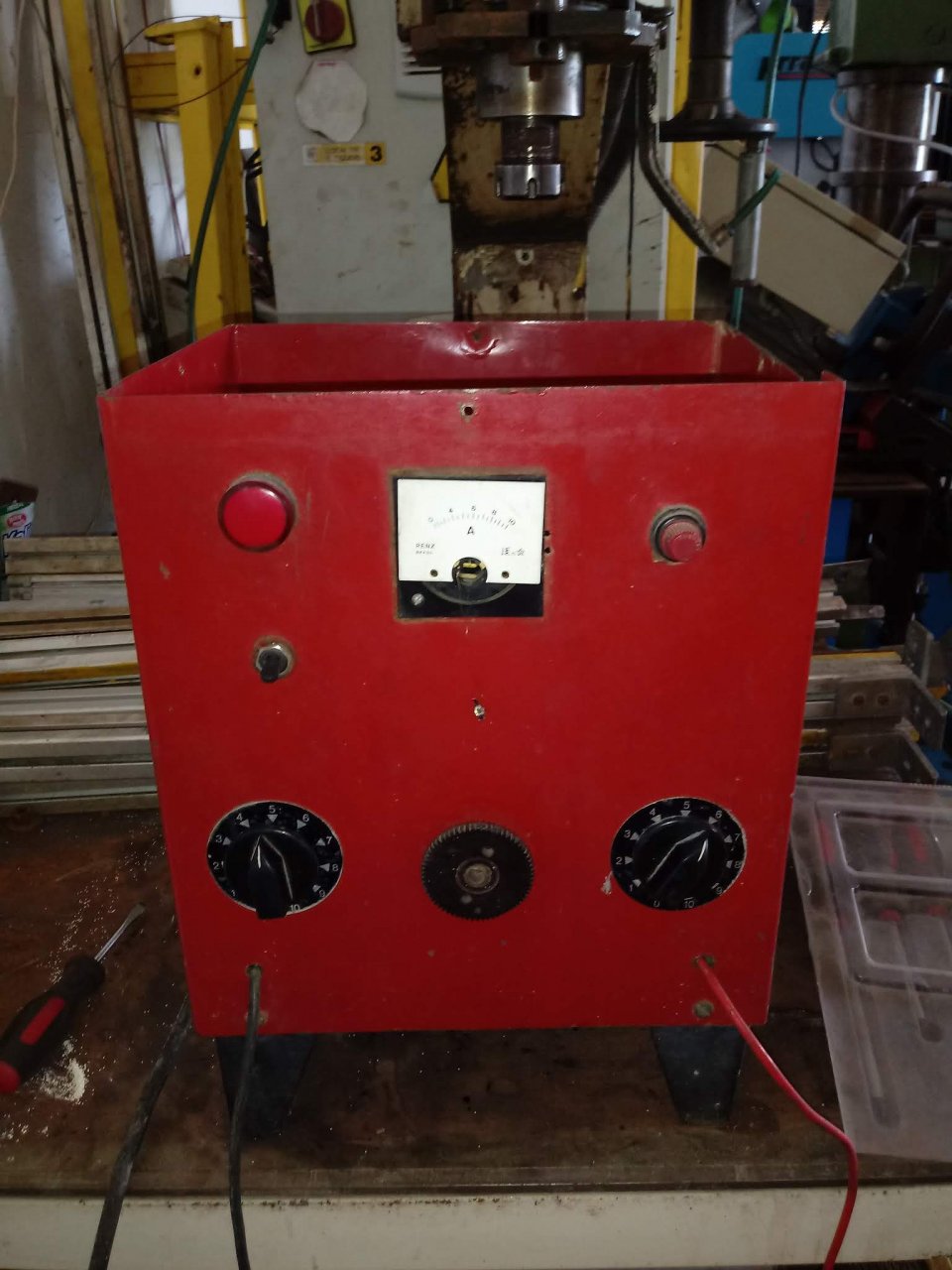

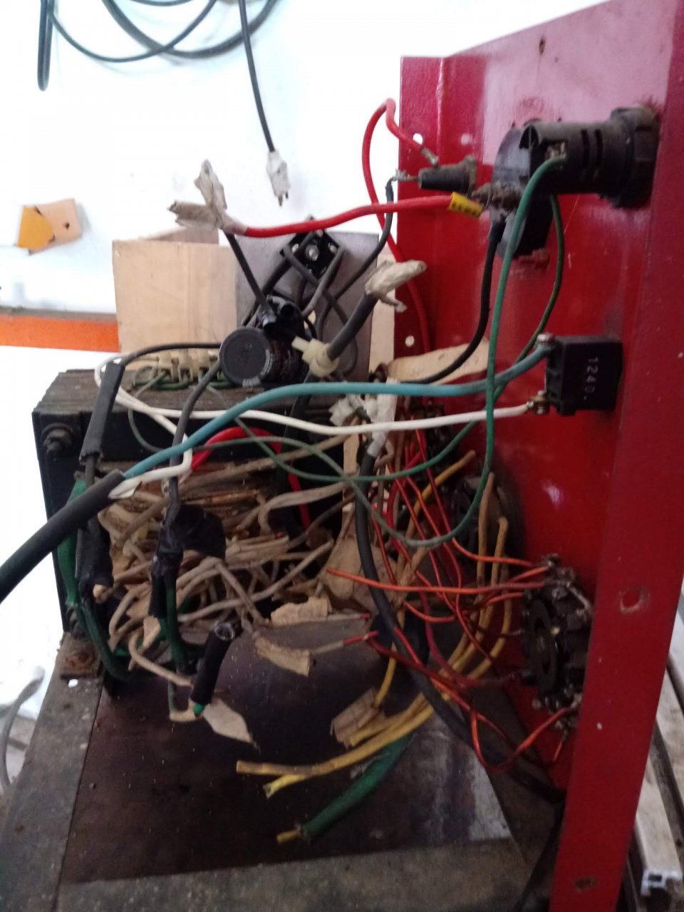

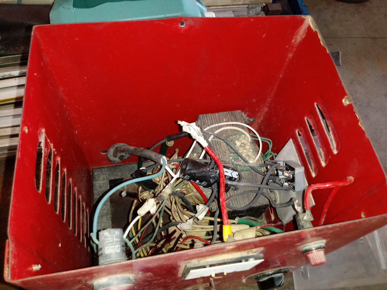

Here is a picture of it and of its internals, the circuit is very simple and I think I understand it well, but there are still some things i can not

The circuit itself is composed from a transformer, which has different windings yo get out different voltages. These goes connected to a switch for voltage selection, then they go to the rectifier bridges, from there there are 2 electrolitic condensers and from there they flow goes to the battery leads, the negative going directly to the negative of the battery and the positive passes through an AM meter then a fuse and then to the positive battery lead.

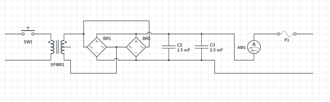

Here is a schematic of the whole circuit. Originally probably this went to some more switches, which i dont know why.
Schematic

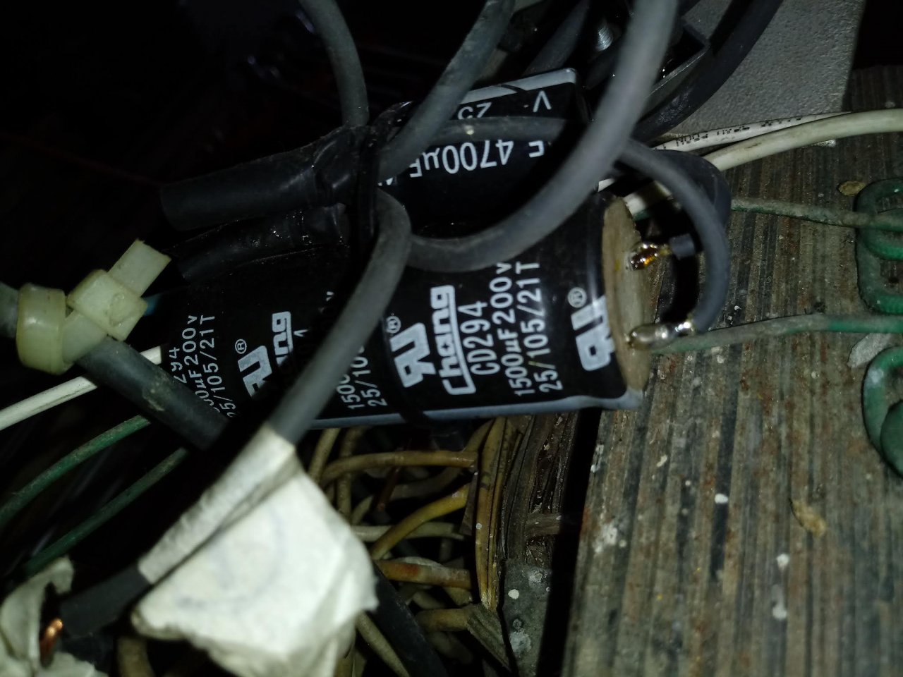

Here is the photo of the capacitors and their values are 4700uF and 1500uF , if i get it correctly since they are in paralel we can
consider it as one cap of 6200uF , correct ?
One first thing is that I have no idea on why the primary winding of the transformer has another one which divides the main voltage from 128V and give the voltage of 65V , why does it need that ?

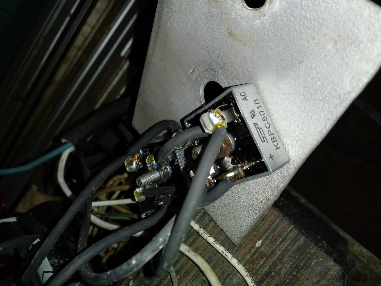

The other thing I do not get is why there are 2 rectifier bridges ? BR1 and BR2 are KBPC5010 .

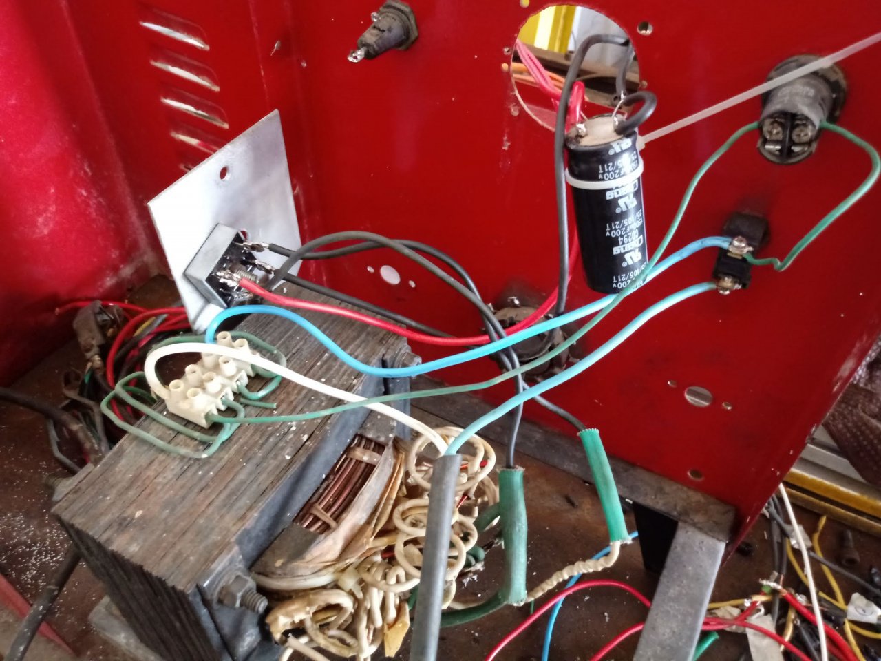

Here is a picture of how it is right now rewired.

First the voltage you are reading on the capacitor is pretty nornal. With a rectifier and a filter the no load voltage=input x 1.414. In this case 17.7 x 1.414=25v.
I may have missunderstood the transformer connections. The two dials shown on the front panel appear to be some kind of dials. What I would suggest is to get a regular headlight bulb and connect it in series with the + terminal of the battery and the + output of the charger, then measure the voltage on the battery. If the headlight bulb is fully bright then the output from the charger is a large current. If the headlamp is dim then the current is low and the charger my be fine to connect to the battery.

The 2 dials on the front, the left and right one have been used for voltage selection one, but the other i have no idea what was used for. They are both kind os switches. The center pin was used as output and on the side of the dial there was connections where
all the wires from the transformer secondary went on, this was permitting to switch the output voltage. I will see if I post the pictures of it.

Why does this simple circuit have parallel-connected bridge rectifiers?
If it was two separate transformer windings as you stated, what does the floating voltage feed?
In fact this is what is intriguing me from the beginning. I never understood why those 2 bridge rectifiers are in parallel. After some reading
I could conclude that this would be due to better handle the amperage passing through them if I understood it correctly , but this still implies in a
problem if one of the bridge diodes burn then it overloads the other one. I am not sure if this is correct.
