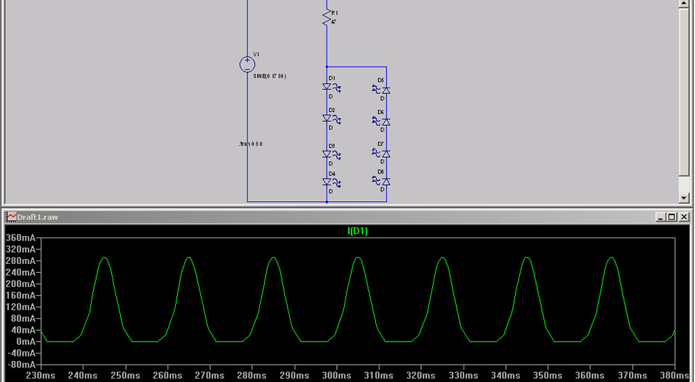

it looks perfect. Is it possible to connect parallel another 4 LED that would be 8 LED all together ?
You're better off connecting two strings of 4 in reverse parallel for 8 LEDs.
Also, you might as well get rid of the capacitor and use a 47R resistor.
Please let me know if i understand you correctly, here is circuit.
Looks fine to me, except if you want to simulate it you'll need to enter 17V as LTSpice works in peak voltage, not RMS.
So i tried to simulate it and current seems to be very high through diodes. Does it current (300mA peak) won't damage diode ?
Sounds like you need to use a bigger resistor. Just watch for the power dissipation in the resistor as well. Also make sure the voltage charactoristics of the LED's you're using in the simulator match your real diodes.
It depends on the forward voltage drop across the diodes.
What's the Vf of the diodes in the simulation?
I went on the fact that white LEDs have a forward voltage of about 3.5V, four in series makes 14V. (17-14)/47 = 63.8mA and the LEDs will only be conducting every half cycle for less than half a cycle, giving an average current of much less.
Vf for this LED diode is 0.8V (LTspice) and therefore is current so high in simulation. Real Vf for white LED diode is about 3,5V....
