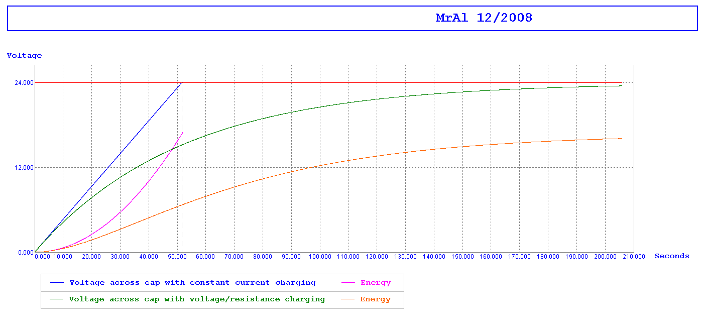

Hi again,
If the speed decreases then the area of the field swept out by a length
of wire in a time dt decreases which in turn causes a decrease in the voltage.
Also, the voltage and resistance is a better way of looking at this
problem anyway. This is the other problem i hadnt talked about in the
previous thread
I've included a graph to compare the two different views on charging
the capacitor. The blue indicates the voltage charged by a constant
current charging source, and the green is charging by a generator
that puts out a max of 24v and has an internal resistance of
24/27 ohms. The respective energies are shown in violet and orange.
We can see it takes a lot longer to charge than with a constant
current charging source as you were presuming. This will be more
realistic, although a good test would be in order before buying parts.
It takes roughly 3 to 4 times longer to reach the same energy level.
Get a smaller cap and test the time it takes to charge to 24v (or whatever
that generator puts out) and we can do a more precise calculation
after getting the results of that test.
For example, how long does it take to charge a 1F cap under the
exact conditions that will be used for the final design.

Hi again,
Sorry, i assumed that if the OP could get a 58F cap then he would be able to
get a 1F cap even easier. Does this sound like an unreasonable assumption?
I also assumed that the OP had the other stuff like the generator.
Just a note on the speed again...
If the speed decreases then the base voltage decreases, which because
of the series resistance will force the current to decrease. This of course
means that both current and voltage will decrease when the speed
decreases for the same load.
If you want to charge the cap up to say 24v then the generator has to
be able to put out at least 24v and preferably even more than that.
A good estimate would be to use the familiar equation:
V=Vm*(1-e^(-t/RC))
where
Vm is the motor voltage (assuming open circuit and constant speed)
t is the time in seconds
R is the resistance of the motor in ohms
C is the capacitance
V is the desired charge voltage (and total energy = C*V^2/2 as before)
e is the natural log base, e=2.71828182845904523536
