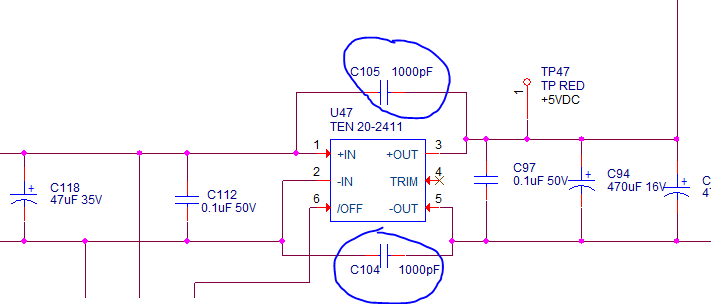

Why would there be capacitors across an isolated dc/dc converter input and output terminals as shown?

Normally you don't want capacitance between the input and output of an isolated supply, so I don't understand what those capacitors are there for. :confused:
Switching power supplies make noise. These capacitors help short this noise out.
This is the simple answer. The complex answer involves the inter winding capacitors in the isolation transformer.

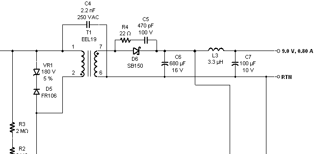

All AC to DC swithing power supplies have a capacitor from primary to secondary. 1000pF 1kv, power line rated. You have to have this to get noise rating. See C4 below.

The "off the shelf DC-DC bricks" that you can get have the caps inside.

You will be hard pressed to find one. Even the power supplies for high end test equipment has these capacitors. I design transformeres that have low primary to secondary capacitance and noise cancelling windings and I still add the caps.
capacitors gives you an AC loop
Yes, There is noise from the transformer and I am trying to return the noise back to the source and not let it get into your loop. With out the cap the sharp edges on the MOSFET/Diodes will push through the 100s or 1000s of pF in the transformer and the noise will pound your isolated supply.

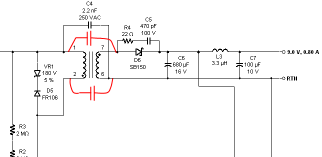

The two capacitors I added in red are inter winding capacitance in the transformer. You can see the wave form on the MOSFET couples directly to "RTN" on the isolated side and the sharp edges on D6 couples back to the input supply. With out C4 there will be a huge amount of common mode noise on the output.

The two red capacitors I added in post #10 are part of the transformer and not added to the PCB. The two caps in #5 are on the PCB.

What noise:
Fly back switcher, one primary, one MOSFET, One end of primary at supply (350V), Other end at MOSFET.
Place scope close to the primary of the transformer. One end of the primary is quite. The other end is radiating noise. (sharp edges, 600V in 20nS)
Transformer:
The primary and secondary are two pieces of copper spaced very close together. (definition of a capacitor)
The switching noise cap. couples to the secondary.
If the P to S cap. is 10pF and you add a 10nF capacitor on the PCB from Primary to Secondary (grounds) you then just made a 1000:1 divider that reduces the switching noise on the secondary. (more complicated but....)
