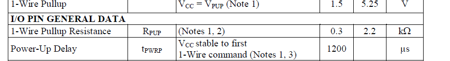

I've got a board with a Pic16F18854 and a DS2411 OW device. There's a 1k8 pullup resistor on the data line and eventually I'll add new devices but for now just a single device.
When I call OWreset() it returns a presence pulse so I then send a ReadRom (0x33) command to read the ROM but only get back 0xffs indicating that the device isn't responding.

Edit, I've checked that the pin goes low after assertLow() and goes high again after release().
According to the datasheet, the pullup should be no higher than 2k2 and no lower than 300R!!! I originally had 4.7k as that is what I used for the I2C pullups but changed it when I saw the datasheet.

Found the first problem. In,
uint8_t OWreset(void){
    assertLow();
    __delay_us(560);
    release();
    __delay_us(67);
    uint8_t temp=OWpin_R;
    __delay_us(60);
    return(temp);
I'm checking for a high presence pulse when of course it will pull the line low if present.
Changed the end line to return(temp==0);
I must also have changed something else but not sure what.
I finally dug out some old code from about 5 years ago and this code had the same problems but occasionally worked!!!
It was only when I got the scope on the signal that I realized what the problem was. Occasionally, one of the pulses would be the wrong length!!! It was being interrupted by my ISR. Disabling interrupts around the time critical bits fixed all problems. The ISR is for I²C and other stuff but the I²C can occasionally use clock stretching to give it a little more time. Lesson learnt - remember to look for the newbie mistakes first.
Hopefully, someone will google this in the future and it'll help them along.
