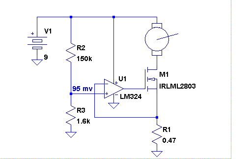

Here is a current limiter that looks about like a 0.7 ohm resistor in series with the motor for currents below 200ma. At 200ma, the voltage across the motor will drop depending on the load on the motor, but the current will be 200ma independent of the load.
For the unused op amps in the package, tie the output to the inverting input, and connect the noninverting input to GND. This will prevent the unused op amps from screwing up the bias on the ones that are used.
A better solution might be a low dropout voltge regulator with current limiting, but this would be more complicated.
