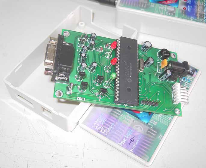

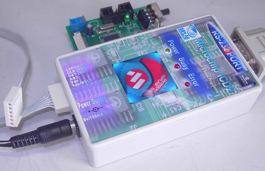

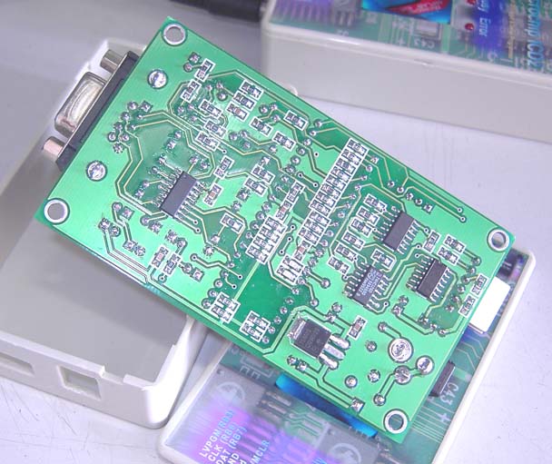

Here are a few pictures of my ICD2.The colored cover is certainly unnecessary.I just happened to have this idea of using a digital photograph as a font cover of DIYed devices.Tried out and....it looks good,doesn't it :) Cheap way for high quality graph,huh?

Your ICD2 looks lovely!
BTW: My ICD2 is also powered by adapter, the +5V supply is separate to add more current then ICD2 can...
Thank you!Jay. :)
The box...Ah!A stand alone power supply for target board you mean,I have a 5V switch mode supply,so such a power device is not necessary for me.

I built my power supply year ago, so when I was designing ICD2, I build only weak +5V source (saves $ and time). Also I use that power supply for other purposes than PICs and using ICD2 as a power source is kinda impractical (Has to be on and in contact with MPLAB).

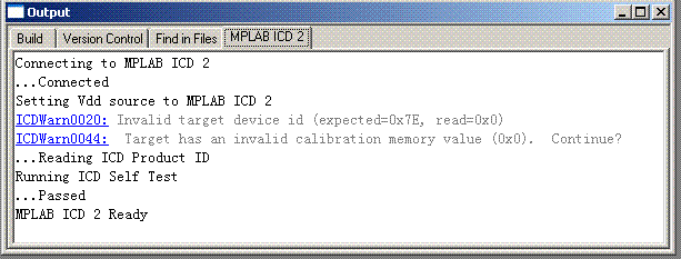

For the 12F675 problem: You CAN program (IntOSC & MCLR_OFF) it, if your code is using PGD & PGC PINs as INPUT.

I took a screen shot on my computer.You can see the system warning.MPLAB virtually didn't find any chip.So I have to make it find the 675 to program it.I wonder how your ICD provides Vdd&Vpp,as well as how you built up your garget circuit.Thanks!

My ICD2 was discussed in
pictures are before I made PCB for it...
