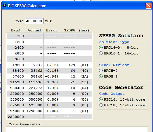

Nicely worked out cadstarsucks, but you misssed the fact that he's using the 18F in HS+PLL mode, which means it runs at 40Mhz instead of 10MHz. But what you probably didn't know is that the PICList has an online generator for these values at this gives either a +1.4% (43 and BRGH=1, or 10 and BRGH=0) or -0.9% (42 and BRGH=1) error using 40MHz.
My SPBRG Calc application shows similar results with better tolerance for 57600 baud using BRGH=1.
The SPBRG Calc spreadsheet (post #1) and single file application (post #5) can be found on this Forum.Microchip thread; **broken link removed**
spbrg-calc-screen-shot-png.11681
The Spreadsheet can provide SPBRG solutions for non-standard baud rates (by editing the BAUD rate cells in the left most column).
