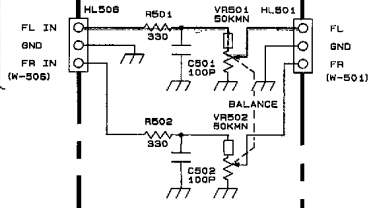

I have a Harman Kardon AVR30 receiver, which is about 20 years old. It still works perfectly, but the balance potentiometer cuts off on certain parts of its travel.
This is the second time it fails. The first time I repaired it myself, by replacing the pot with a similar one, but several years later fails again. I wish to cancel the balance function, since I never use it.
Please refer to attached schematic, with balance pots marked VR501/502. If I remove then, can I leave an open circuit? or do I replace them by fixed resistors?
I would be grateful if you could advise me.

Below is a schematic clip of the pot's circuit.
What you replace them with depends upon what the pot settings are normally when using those inputs.
They appear to be dual pots, so if they are normally set at the 50% point (half-way between the pot extremes), then just replace the pots with two 24.9kΩ ±1% resistors in series to ground, with the output taken from the junction of the two resistors.
Just disconnect the pot entirely, and wire from R501 to FL, and R502 to FR.
No need to put resistors in (it might be slightly louder, but that's what the volume control is for), and if you did they would't be 50/50 as the pot will be log/anti-log - 50/50 would make little difference.
balance pots are so seldom used (by the user). you could just jumper the wipers to the signal end of each pot.

Hi Uncle, thanks for your tip, but I'm not an electronics dud and the only wipers I know are those cleaning my car windscreen. Do you mean I do like Nigel suggested: "Just disconnect the pot entirely, and wire from R501 to FL, and R502 to FR."
Yes he does, the wiper is the centre contact (the little arrow on the symbol) that 'wipes' along the track.

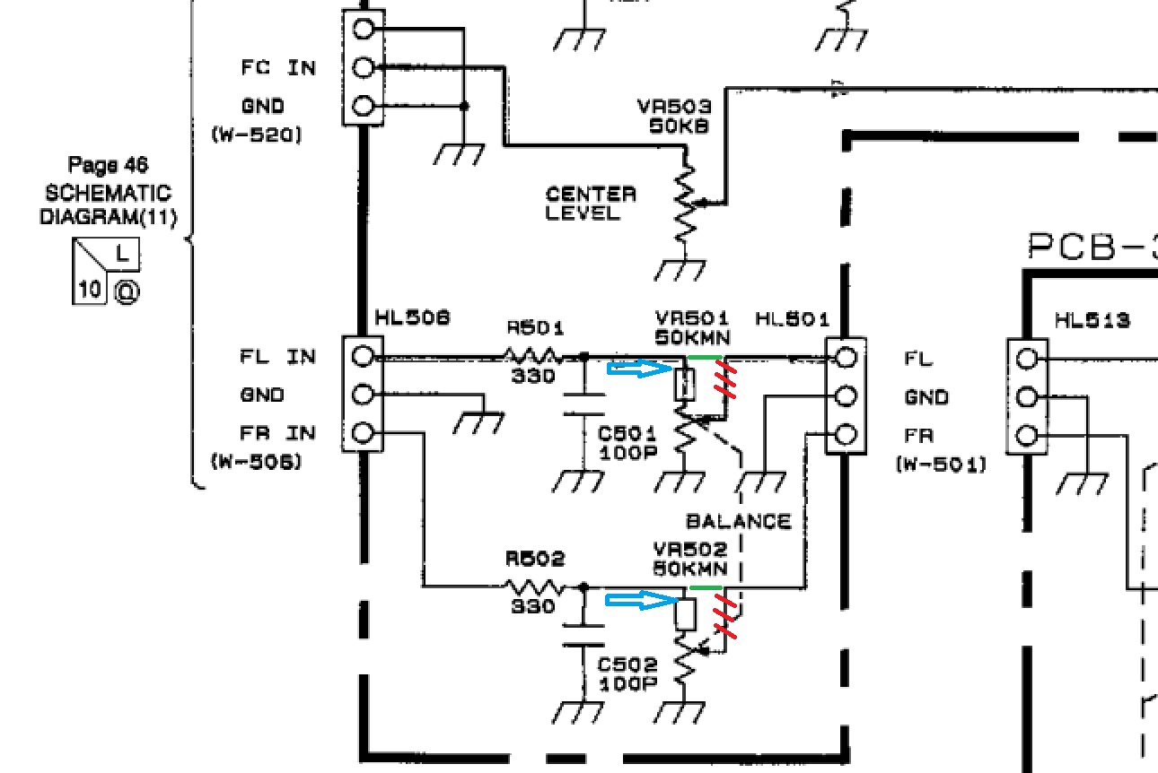

Hi Nigel, thanks again. But just to play it 100% sure and before I open the unit: if I got it right, I must open the connections in red and rewire them like indicated in green. My question is what to do with the pot end showed with the blue arrows, should I keep it connected, or should I leave it open and floating?

I carried out my mod yesterday. It took me a while because the receiver's box is quite tricky to open, with most control pots fixed onto a PCB. I shorted the balance pots as you guys suggested and it works perfectly fine, the balance control is now cancelled and sound levels are equal between both channels. Thanks again for the advice.
