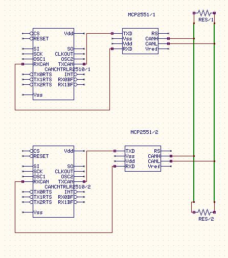

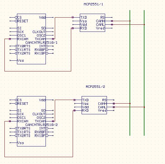

So something like the circuit below should work? what sets the voltage on the transmission lines? do they require a power source other than the transceivers?

edit - Forgot to attach the circuit, doh...

You can have 3.3V transmission lines or 5V transmission lines. There may be others as well. Some transceivers use the same supply for both sides, some have separate power pins. In this case, you can use different logic and line voltages. You can use the same supply in this case, or an isolated supply (to protect against transients in the transmission line). .
Your schematic has the right idea, except you need 120ohm termination resistors at both ends of the line to prevent reflections (all other connections to the line must go in between these two resistors. Go to microchip or atmel website and search their app note on the CAN protocal. Some ICs also have a third pin so you can set the neutral voltage of the line (with two 60 ohm terminations resistors per end with this neutral pin connecting at the mid point)
So this should work (see below, res/1 and res/2 = 120:ohm: )
I was getting confused by the app. notes giving the output voltage levels of the chip on to the canbus, but then saying that it supports both 12v and 24v systems... which is neither its output / input characteristics or its Vdd...
anyways, thanks for helping out a n00b.

Yeah, I'm not sure what they mean by that either. I'm pretty sure they aren't talking about common mode voltage. I don't think the datasheet says the supply voltages for the line side can get that high either.
