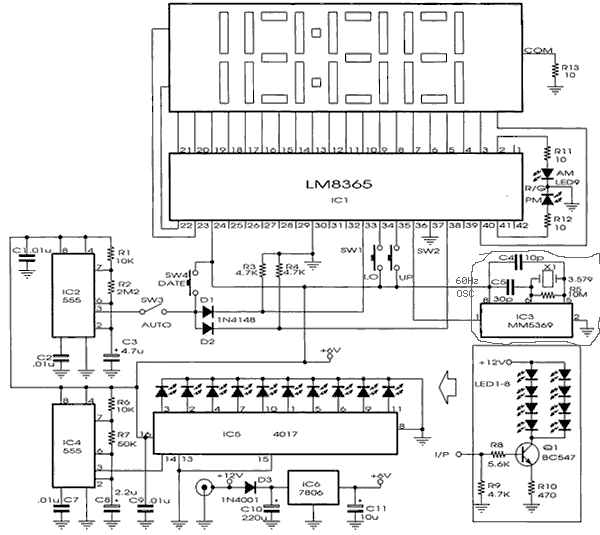

Can someone help me in designing a frequency 60Hz range.
Can someone suggest me a block diagram, and circuit diagram if available. (Everything except IC MM5369)
Please see attachment file
Thanks and best regards.
Lamct

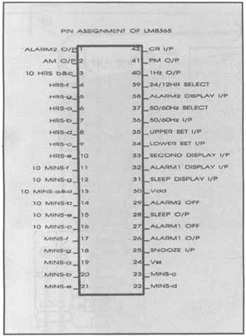

I couldn't find the datasheet for the LM8365 (at least, not for the one you're using).
If you have it, post it here and maybe someone will be able to help you.
The LM8365
I don't have datasheet for the LM8365, only a Pin assignment of LM8365
Help me pls.
Regards
Lamct
