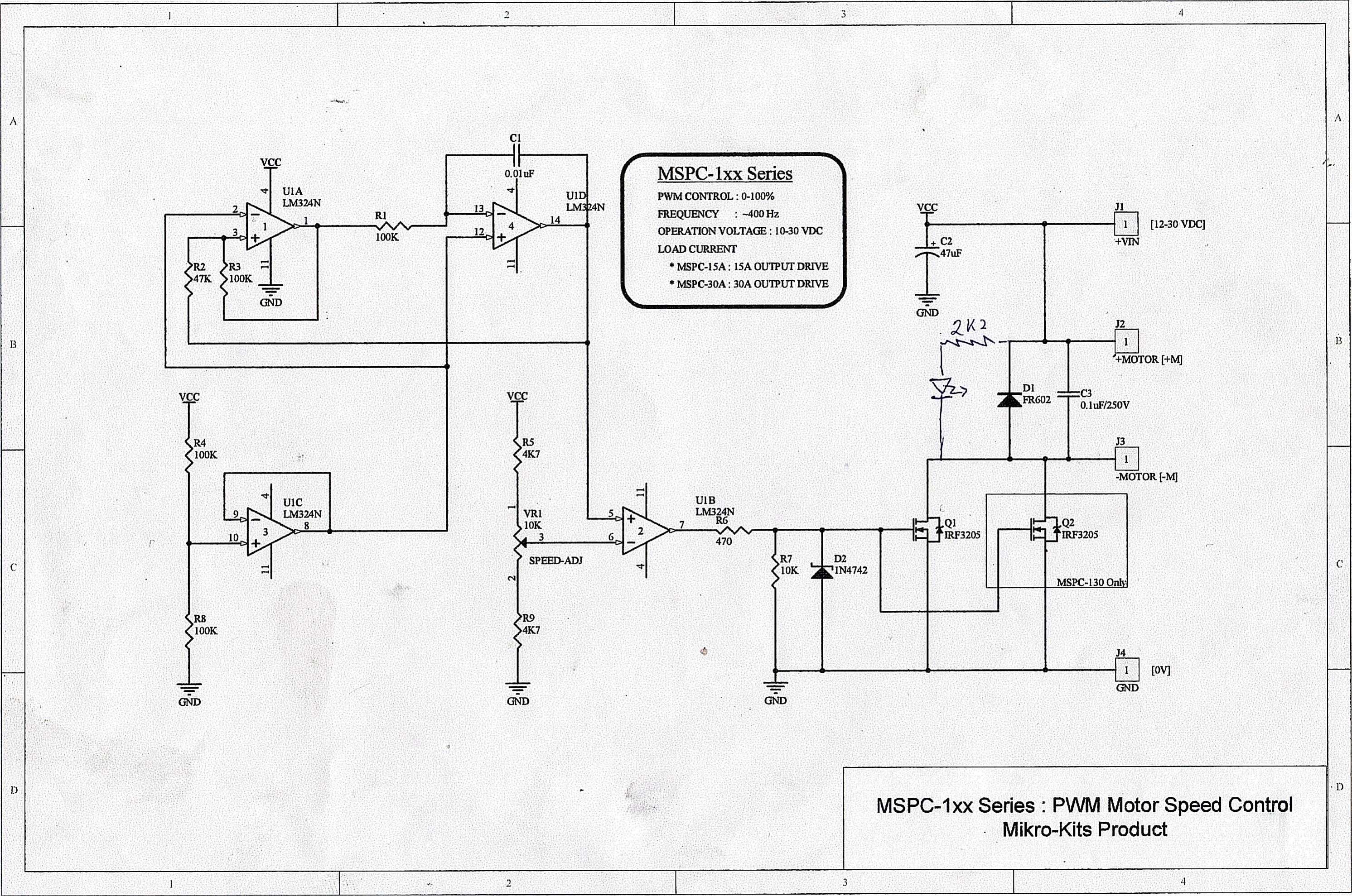

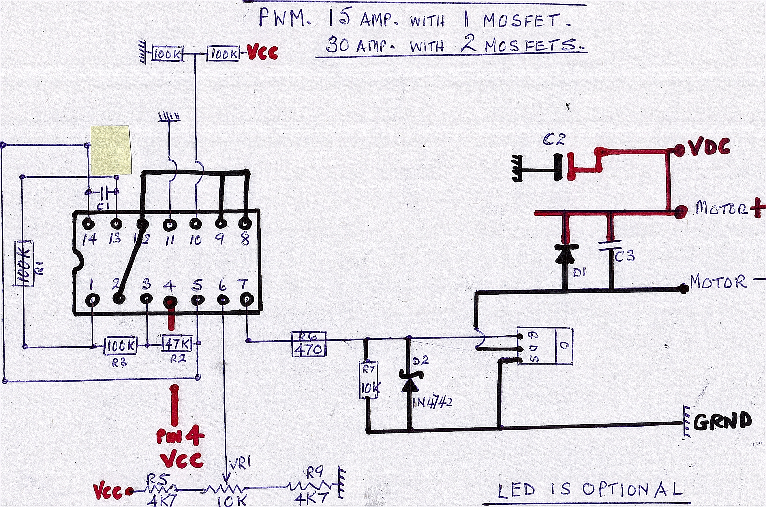

Dc motor speed control
The best way to control the speed of a dc motor,is to adjust the ampage draw.This is done with a Pulse Width Modulator (PWM) a motor of your specification 12v @ 6amps,should not create any problems.A PWM using 1 mosfet & a LM324N Quad-op-amp,is capable of 15 amps continuous.there are very few other components required.If you decide to build one,just bear this in mind,never ground the drain pin of the Mosfet,never use the PWM without a suitable heat-sink (even for testing)& use a 14 pin socket to mount the Quad-op-amp. here's the diagram,& a rough schematic.good luck.

Thanks for the diagrams I need something like this myself and stumbled apon this thread.
Ill let you know how it go's for my project which is sort of similar to the original apart from some basics.
reversing & speed control
Hi. zorbzz, Thanks for the interest,I've improved the info,so you might find this pdf usefull,any help you need,"just ask" Terry;
