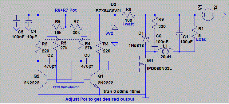

Can we use such PWM duty cycle as a DC to DC cellphone charger/converter?
The schematic looks okay.
Don't know why you're not getting 5V out. What's the voltage across the zener?
Hi, I experimented with few series resistor of zener and got different voltages. For 5.1 ZD, I used 2.2k and got 4.8V reference and output voltages. With 1K, got 4.9V and with 330 ohms, got 5.01V but this time 330 ohms got hot!
So I used 5.6V ZD and used high value resistor- 15K to get lower voltage than 5.6V. And yes, I got 5.3V output and charged cellphone with 450mA current. But N-MOSFET need a little bulky heatsink (getting hot with 3x2x1.5cm heatsink), so boaring! :(
Wish to get MC34063 so portable charger IC!

Hi again,
And now I am trying to experiment by modifying your LM339 based 12V to 5V supply. I want to use a simple blocking oscillator to generate frequency. And the frequency amplitude will be regulated by series resistor and a 5.1V zener to Gnd. And want to feed Gate of the mosfets. Finished! Are there any possibility?
Actually I am confusing how your device is working! There's 12V peak frequency exist in the gate of N-MOSFET however its output is just 5V comparatively to positive. I found the signal fed to gate is just almost 30% ON and 70% OFF. So it's PWM creating the 5V output, comparatively to positive 12V?

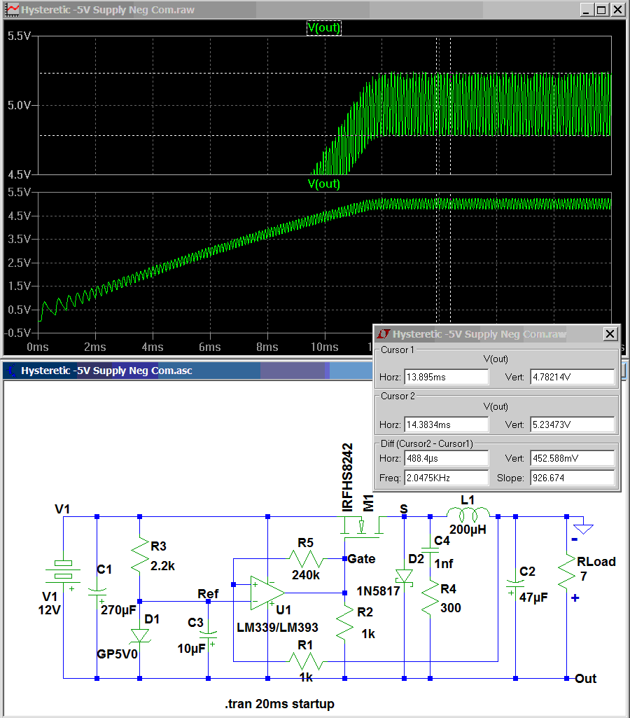

Below is a simulation of the circuit with the changes you suggested (as I understand them).
My simulation showed that the comparator was fast enough to operate with a 20μH inductor but I increased its value to the minimum you suggested.
I initially didn't include any additional hysteresis because the circuit simulation operates fine without it. But in the actual circuit some added hysteresis may be needed to curb oscillations from any stray feedback between the comparator input and output. That's generally a layout and decoupling issue.
With the added hysteresis and smaller output capacitor, the output ripple is about 450mVpp, which seems rather high as compared to about 50mV for my original circuit. Thus it's not clear that your component values are that well chosen either. I particularly don't understand why you want a smaller output capacitor (?).
R4 and C4 are to damp high frequency oscillations from the inductor and any stray capacitance that can occur when the MOSFET switches off.

I followed your design and tried to make the circuit simple. How it looks? It has no feedback so I could use it as variable regulator, output voltage monitoring is not added though.
