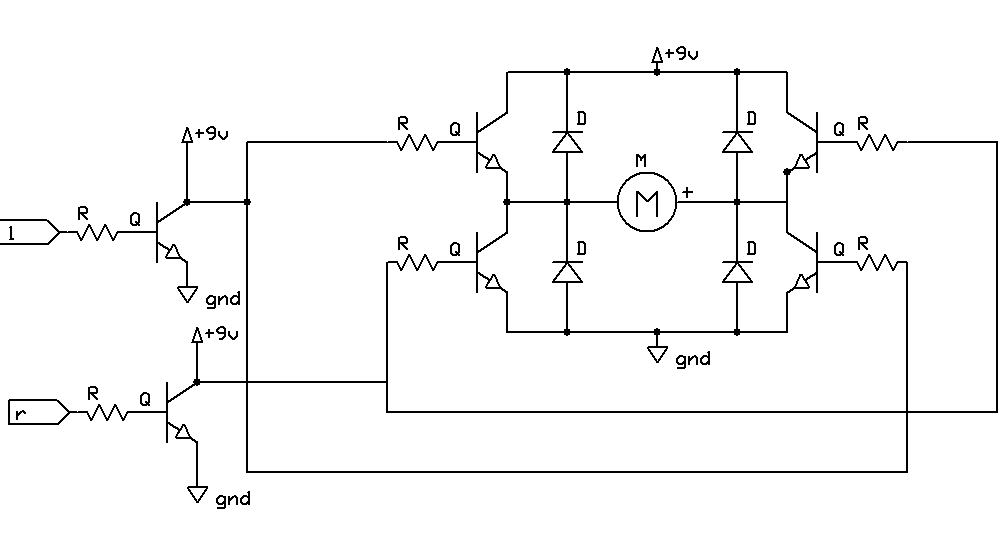

OK, I was fiddlin' around today and I made this super simple circuit for infared obstical avoidence. Well, I just want some opinions(good or bad), so I'll hand over the diagram.
Please note, all transistors are 2N3904 unless otherwise stated.

Thanks for all the info. I didn't really think about the power consumption of the ttl chips. I was just wondering, If I used this H bridge, would it work better? I designed it with both suggestions in mind:
-Diodes for reduction of EMF interferance
-third set of transistors that will give a 9V signal to the h bridge for more power, but still run off a logical output.

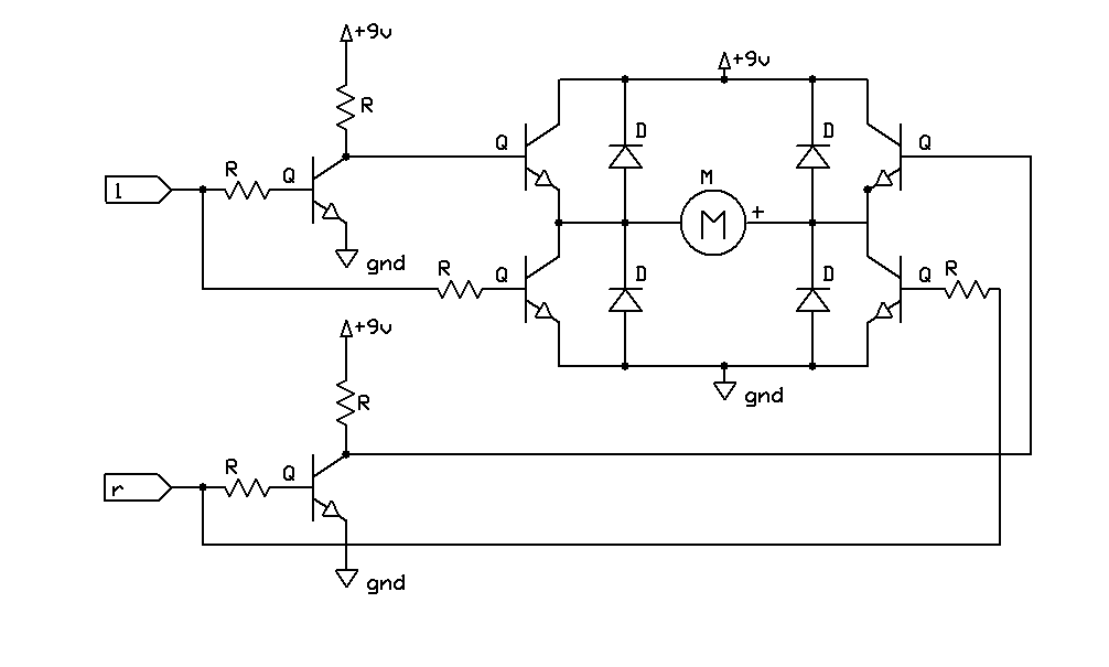

The new transistors you added will go up in smoke, because you have no collector resistor. I have edited your schematic and posted it below. Note that you don't need resistors in series with the bases of the emitter followers.

thanx. are the values of the collecter resistors and the one connected to the base important?
The collector resistors provide base current to the emitter followers. The base current will equal motor current divided by beta. Let's say your motor current is 100ma, and transistor beta is 50 (this is just an example). The base current will then be 2ma. If you use 500 ohm collector resistors, they will drop 1 volt. Adding this to the base-emitter voltage of ~0.8v, the emitter voltage will be 7.2 volts. You've lost 1.8 volts of your potential motor drive.
The new transistors will have to sink 18ma (9v/500 ohms in this example), so you should scale their base resistors to supply about a milliamp.
The lower transistors have to sink 100ma (in this example), so you should scale the base resistors to supply about 5ma(!). This is because beta goes to hell at low Vce, and you want to make sure they are saturated. That's 6ma from your logic gates - not impossible, but TTL gates won't source that much current unless you use a buffer or add a pullup resistor. You can see that bipolar transistors are not ideal for H-bridges. I would personally use complementary MOSFETs - P channel pullups, N channel pulldowns. I'm sure you can find examples on the Internet.
