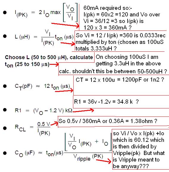

Hi to all,
I have decided to build a step up circuit using a TL97acn IC.
I have 12v input and am aiming for 36v out at 60mA.
This is well within the specs of the IC and the circuit is quite simple but the calculations to get the values are making me think I must be working something out wrong.
If someone could check this for me I would be grateful and then could stop worrying that I will release the ICs magic hidden smoke hehe.
I have posted my working out and the datasheet it comes from.
Thanks in advance..Al
  • TL497ACN.pdf
    TL497ACN.pdf
You inductance calculation is wrong.
To get 360 mA from 12 V in 100 µS you want a 3.3 mH inductor, or 3300 µH. That is higher than 50 - 500 µH, by 6 times, but that is closer than 3.3 µH is to 50 µH. I think that 100 µs is quite a long time and the switching frequency is too low.

Hi mate,
I chose the 100uS as it was an easy figure and roughly mid way between the shown limits.
Would it be better to change the on time to a smaller one? Also any suggestions on the output cap as however much I read the sheet I can't find any info on choosing it, ripple is not mentioned at all!
Any help is appreciated, thanks Al
Edit. I can't get the Ton above 15 using the formula given without going above the suggested 50 to 500uH values, worked out as follows:- L (uH) = Vi divided by I(pk) x Ton which in my case is 12 / .360 = 33.333r and saying Ton is 15 gives a final value of 500.
Considering they say choose inductance between 50 and 500 uH and Ton between 25 to 150uS, how can this formula ever work out in their expected range? Unless I am making some weird mistake?
100 µs as the Ton will mean about 30 µs Toff, and the total is 130 µs, so the frequency is about 7.6 kHz, which might be audible, if there is any movement on the inductor.
The IC data sheet gives the formula for the output capacitor, but you have to decide how much ripple your circuit can stand. You know that you want 36 V and 60 mA so you must know what sort of load it is. If you tell us, we might be able to advise how much ripple will be tolerated.
The only problem with the formula on the data sheet is that it ignores the ESR of the capacitor. That will add Ipk * ESR to the ripple.

Hi again folks,
I am getting really flustered now with the equations and results of them.
I have dropped my voltage requirement from 36v to 28v so as to be well within the ICs limits but:-
Here are the new values Vin =12v, Vout = 28v, Iout = 60mA, I(pk) = 280mA.
If I use the recommended value for the inductor of between 50 to 500uH then the Ton value does NOT match what they say.
If I use a timing cap of say 220pF then according to their scale I would expect the Ton to be between 20 and 21uS but my calc gives 18.3333.
Please please can someone look at the equations and see what I am doing wrong.
Al
It won't match with such a small current. Just use a larger inductor to keep the current down and the Ton up to what they suggest. It won't hurt.
Sounds close enough to me. That is a very small difference.

Hello again,
The simple answer is that whomever wrote up that data sheet made a mistake or else they meant to imply some sort of other conditions to those values. In any case, you should ignore that very part of the data sheet and proceed according to the equations given and whatever inductance you end up with you end up with, and that's what you use, whether it is 50uH or 5000uH.
The equations, unlike the rather restricted range they quoted, look correct so we'll use them. They should render us some good enough values to use in an actual circuit.
We'll start with a Ton of 100us and then work our way down by dividing that in half twice, giving us 50us and 25us, and then you can pick your favorite set of values :-)
For an output of 28v we set the target output voltage to 29v to make up for some losses.
With Vout=29 and ILoad=60ma we get an iPeak of:
iPeak=2*ILoad*Vout/Vin
with the constraint that iPeak<450ma for some margin of error, and we get:
iPeak=2*ILoad*Vout/Vin=0.290 amps
(and that meets the iPeak constraint so we're ok so far)
and with a Ton=100us that means L comes out to:
L=Vin/iPeak*Ton=0.004138 Henries
and we'll increase that by 10 percent for some margin of error so we get:
L=0.004*1.10=0.0044 Henries.
We can also calculate Toff:
Toff=Ton*Vin/(Vout-Vin)=70.6us
and the duty cycle D:
D=Ton/(Ton+Toff)=0.5862
and just to check the output voltage:
VoutCheck=Vin*1/(1-D)=29.0 volts
and the average input current is:
IinAvg=ILoad/(1-D)=0.145 amps
With a max output ripple of:
Vripple=0.5 volts
we can approximate the value of the output capacitor:
C=(Ton*Vin/Vout)*(iPeak-ILoad)^2/(Vripple^2*iPeak)=30uf
To recap:
Ton=100us
L=4.4mH, and
C=30uf.
All of the above were based on an on time Ton=100us, but if we cut that in half then we can also
cut all of the component values in half too. This would lead to the following:
Ton=50us
L=2.2mH
C=15uf
Since now that is based on a Ton=50us, if we cut that also in half we can then halve all the other
values again. This leads to:
Ton=25us
L=1.1mH
C=7.5uf
So there you have it, three different sets of components to choose from.
In all of these the value of the current sense resistor should be 1 ohm, 0.5 watts.
Another thing to watch out for is the ESR of the inductor. You dont want too high of a series resistance or the output voltage will never be able to reach the required value.
If you are really seeing an output voltage that is just slightly less than the input voltage and all the components are chosen correctly, then there is a good chance that either the chip isnt enabled or the internal power transistor is blown open. This transistor could blow out if the wrong component values were used without that 1 ohm current sense resistor (a short instead of that resistor).
