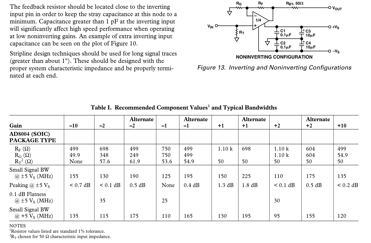

Hello,
I designed a 4CH op-amp configuration using AD8004. I used their recommended values to get best performance. But when I input a signal into any channel I get half of the amplitude as o/p.
My input signal is 1Vp-p. As soon as I connect it to the i/p side, the i/p drops to 510mVp-p (as expected), but the output is at 510mVp-p as well, I adjusted my P1 so that P1+R92 = R93.
Attached is a screenshot of the datasheet and my design. Any ideas?

What P1 does there, floating?
Are you sure the pot is connected correctly in the real circuit. That floating end will turn a gain of 2 into a gain of 1.

I am pretty sure. When I deleted all the rest of the stuff from the other 3 channels to take a screenshot, I accidentally removed the gnd on this too. But, on the actual board it is connected to ground.
Hy pavanbabut,
If you redraw the circuit so that it represents exactly what you have wired up and so that we can read it, may be we can sort your problem.

I don't think so, this is running at ±5V supply and more over my required gain is +2 which gives an output of 2Vp-p. My actual input itself is 1Vp-p. Let me know if you think otherwise.
