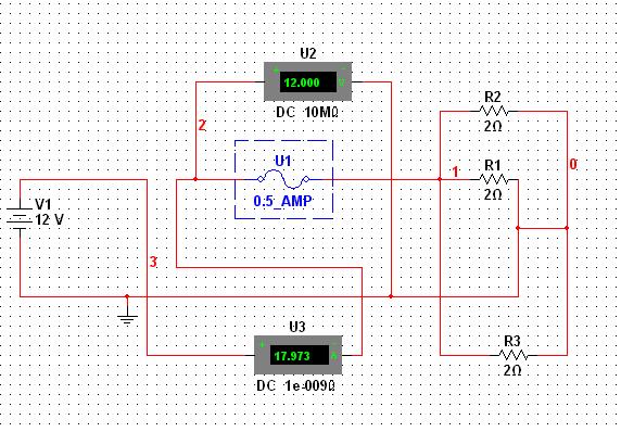

wejos Member Sep 23, 2010 #1 hi guys, i was simulating a 0.5A fuse but i can't make it to blow. what am i doing wrong here? thanks in advance. Attachments fuse.JPG 79.6 KB · Views: 190

crutschow Well-Known Member Most Helpful Member Sep 23, 2010 #2 Because you have the ammeter in parallel with the fuse, which is shorting out the current. The ammeter needs to be in series with the fuse. The rule is voltmeters connect in parallel, ammeters connect in series.

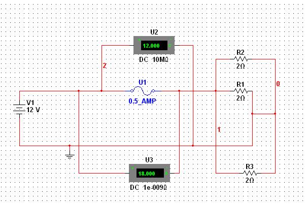

wejos Member Sep 23, 2010 #3 it worked when i changed it to this (attached picture). a quick follow up. so the 17.973A there is what we call the current being drawn? Attachments fuse2.JPG 76.1 KB · Views: 191
