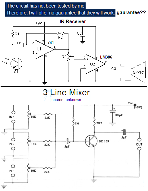

Can someone explain how this circuit demodulates ?
aidob
Hi ,
I hav been given this circuit as part of a report in college , it is a receiver circuit ,
the transmitter being an audio signal , pulse position modulated by a 555 times and transmitted by an LED .
the receiver is this
it is broken down into 2 main things ,
an active High pass filter
and an audio amplifier with a basic low pass filter
can anyone explain , or even point me towards sites or ebooks that will help me understand how this circuit demodulates the Pulse position modulated signal ?
I don't think it does. I see no way to recover the original digital message based on the difference in time of the rising and faling edges or the difference between two rising edges, or two falling edges. There is also no clock recovery circuit, just an edge detector and an audio amplifier. Whooo...Hooo!
Pulse position modulation doesn't require a special demodulator, all that's required is a low pass filter.
Your circuit doesn't have a low pass filter though. The LM386 is an IC audio amplifier. I think the circuit relies on the fact that the frequency of the pulse position modulation is ultrasonic so you can't hear it.
The input should have a comparator to detect the pulses and eliminate AM signals such as backgorund noise from ambient lighting conditions.
my lecturer said that C4 and R5 create the low pass filter (a basic one at that)
or is he wrong ?
I agree that I don't think a demodulation stage is necessary other than low pass filtering, which ultimately your ear provides. This is similar in nature to how you can generate an audio signal using a PWM output of a microcontroller. In that case, the width of the pulses vary so the total average voltage varies at the audio rate and when you lowpass filter, you get the audio. In your case the total average voltage varies at the audio rate also, but by moving the position of the pulses around instead of varying their width.
or is he wrong ?
Yes, he is wrong.
That configuration is usually referred to as a Zobel network.
It provides a load at high frequencies to ensure stability in the amplifier.
By applying some rather perverted logic it could be considered an LPF because it only loads high frequencies, but that is stretching the imagination.
I already answered about this lousy circuit on another site's forum. This circuit is made to pickup the hum from AC powered lights.
The very poor high frequency response of the old 741 opamp is the lowpass filter, but not a good filter because the opamp's gain is very low because it is inverting and has a very high source impedance.
The LM386 isn't a lowpass filter, it has a good response to higher than 100kHz, even with the capacitor boosting its gain. The zobel network does not affect its frequency response. Look at its datasheet.
It is stupid to have a low input impedance inverting opamp creating a very heavy load on the high output impedance photo-transistor resulting in both not having any gain. I would use a high input impedance non-inverting opamp stage so that the photo-transistor has a lot of gain and the opamp can have any amount of gain you want. Also then a capacitor can be added at the collector of the photo-transistor or across the feedback resistor of the opamp, or both, as a good lowpass filter.

I found the original IR Receiver project with its opamp incorrectly biased, and another lousy circuit from another site for the school kids to study.
The new circuit is an audio mixer project using an old BC109 transistor. Look at how it is biased!! No negative feedback, the transistor is a thermometer.
The old BC109 has a current gain of from 200 to 800. This circuit causes severe distortion when the transistor's gain is normal to high because the transistor is saturated.
Both sites have worse circuits that also don't work.
