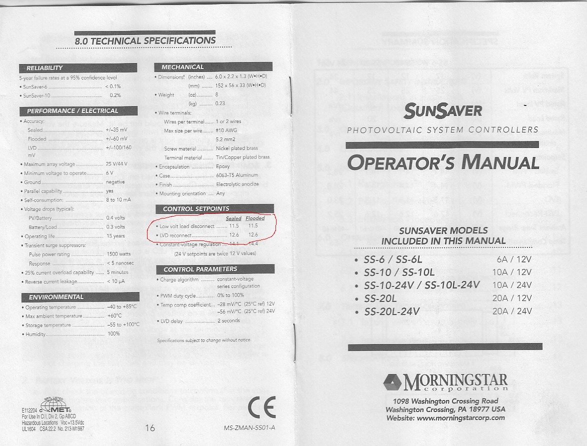

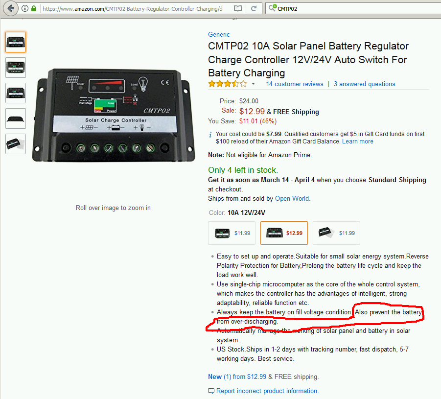

Likely a Chinese typo. That should be over charging. It could be the charger will prevent the battery from powering the panel ( a diode between panel and battery usually does this) but doubtful the controller will prevent the battery from being discharged. As mentioned the controller goes between the panel and the battery. Not the battery and the load. The OP is going to need a comparator with some kind of solid state switch or mechanical relay. In my case I uses a Pic. I then used a LED driver that I could turn off and on with the Pic. The Pic would monitor the voltage level of the battery and turn the spotlight off at a level of my choosing. The LED driver powered my LED spotlight. Way over the top, as mentioned it could be done with a comparator but it was a fun project.
Though it is interesting hey show the load in the diagram. So maybe it does prevent discharge. I would read the spec sheet carefully. You seem to get an awful lot for $12.
Not likely a typo. I have a new-in-box Morningstar SS-10, which I hooked up to a 15W panel and an automotive dome light bulb today. With no sun, the lamp discharges the battery until it reaches ~11.5V, and then shuts it off. It doesn't turn the lamp back on until the battery recharges to ~12.5V (not fully charged). I am going to let the controller run for a few days to see when the lamp turns on (in the morning), and when it goes off (after the sun sets).
There would be no reason for the load current to run through the charge controller unless it is controlling the load current in some way. And protecting the battery from being over discharged by the load is the most likely reason.
