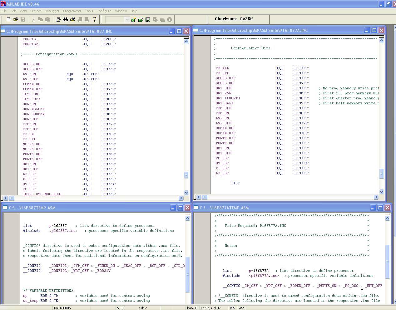

I think it might be config bits setting. I am not well known with these bits setting. On 16f877 I allways used thesse settings : XT oscillator - set, Power up - set, Brown out - set, and all other not set. That was allways good for me. I thought to use the same config bit settings for 16f887. What config bit settings should I use for pic 16f887 ?
There a quiet a few changes in the Config settings between the two chips though not sure which would affect your program from running.
Have not used the 887 chip so not sure of all /any supple coding differenced between the two chips, but providng you have changed the LIST and Include statements to the 887 chip then Mplab should show most differences in the error report - don't just ignore any Warning messages - it will still build OK with them but they might be the clue to the problem.
Look at the Template and .inc files for both chips to see the differences.
Also see this 877 to 887 Migration doc https://ww1.microchip.com/downloads/en/DeviceDoc/41305A.pdf
