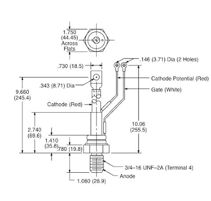

I have some pretty large SCRs or something probably in the 600 amp range with 3/4" threads to bolt it to a heat sink. The bradded terminals are 1/2" diameter. No part number so I'm not sure what these are or if I can use them.
