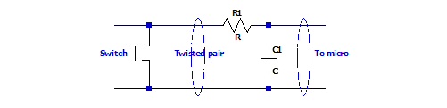

I want to connect reed switch with Microcontroller .
The distance between the switch and Mcu about 15 m .
Can I connect the switch with pullup resistor to Mcu ?
Regards :)
Yes, but to reduce the effects of interference pickup it would be advisable to use twisted pair or screened cable and to connect a low-pass filter before the MCU input.
Here you go. Component values depend on the pull-up value and on the frequency of operation of the switch.
