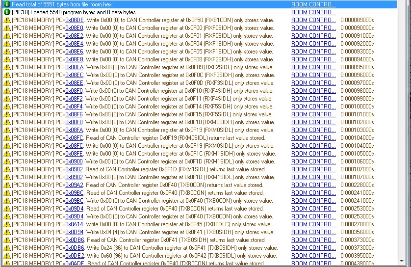

Yes that is correct actually. I have downloaded and included the ECAN library into my code but as soon i initialize ECAN, it sends several errors in to my Proteus Simulation. The reason for this that i believe is that my configuration is not correct. That's why i asked in previous posts if someone could guide me with minimum configurations with which i could start up with.
I have attached the errors image.

They are Proteus warning rather then errors.
Does Proteu have a simulator for the ECAN hardware in the PIC18F4480 ?
