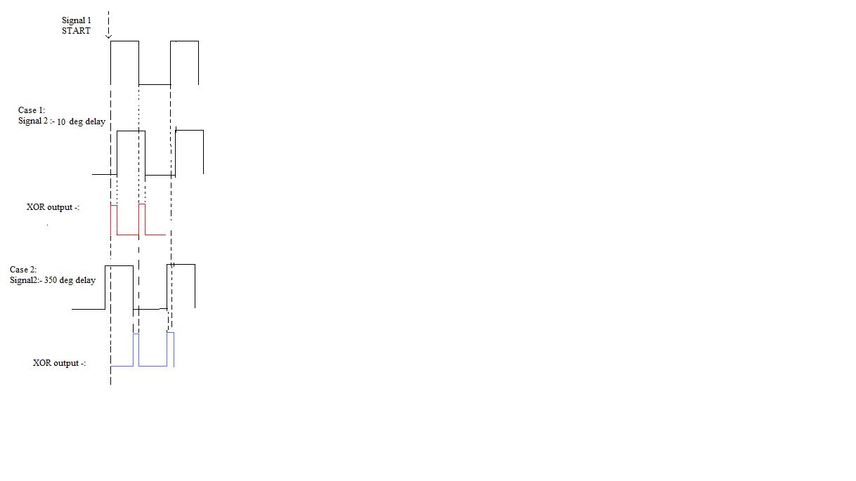

As u have suggested me to draw a few cases, I have attached a diagram where I have assumed two cases of delayed signal [named as signal2]. As far as I could imagine [I might be wrong] that if we take a reference point on signal [signal1] on the rising edge of the pulse, the delay signal will possibly have the two cases:
1) if signal2 arrives as low = that means 0-180 deg delay &
2) if signal2 arrives as high = that means the delay signal [signal2]has
crossed the 0-180 deg of delay range and now
it's in 180-360 deg range.
In the attached diagram, I have taken two such cases, one for 10 deg delay and second one is for 350 deg delay and I have found out that the output pulse from XOR gate has the same pulse width.
Now that implies that for any delay value [in deg] between 0-180 [say 'x'] will have the same value for the signal with a delay of 360-x deg[ In my case,10 deg will be same as 360-10 =350 deg]. I am all confused about how to calculate the phase on these cases?? :(
I apologise Nigel if I have over thought it but I would really appreciate any further help on this matter.
Thank you soo soo much .
Ps: I apologise if the diagrams are not upto the scale.
You are correct, 10 degrees and 350 degrees will read the same, because they are the same - are you needing to know which leads or lags as well?.

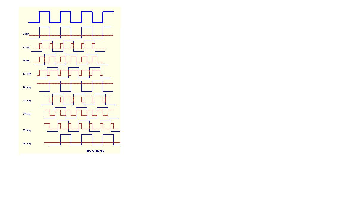

I have found this diagram from a website [attached]. The only other way to find the phase diff of 180+ is that if you look at the signal2 or RX signal waveform and XOR output waveform together [in the diagram], for the phase diff between 0-180, when the signal2 [delay signal] rises, the XOR output is low. For example, for the case of 45 deg, as the signal2 rises, the XOR output is low and for 315 deg, as the signal2 rises, the XOR is high.
Am I right in assumin that if I use a bit test for this case, I can fix the problem??
Lastly,if we feed the XOR output to PIC, will I be using counter to find the width of the signal?? If so then wouldn't the counter value be varied? I mean say for 45 deg of phase diff [for 1000Hz signals] the counter will give 'x' value and for the same phase diff [now for 10 kHz signal] the counter will give less than 'x' value?? So if I read the counter value on the output, I will not b getting the same 45 deg value!
I am so so sorry I sound a bit annoying but I need your kind help on this matter.
Thanks again for your time Nigel.
