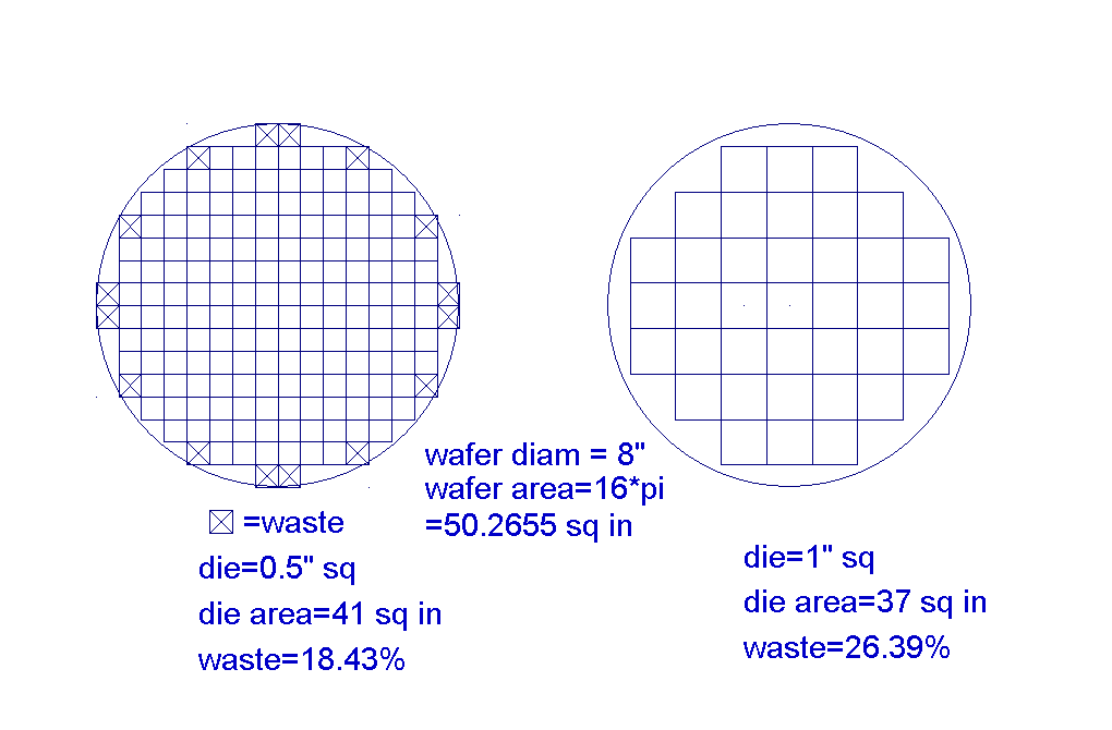

You said the answer is 10%. How could it be a fixed percentage, when you don't know the wafer size and the chip dimensions? The waste can only be expressed as a function of those 3 variables.

OK, I went back and looked at your equations. I followed them down to and including
so n=D^2*.76/LW
I agree with this in principle (n < ((D^2 *pi)/(4*L*W)). This is basically what you said.
At that point, you lose me. If 10% is wrong (which it has to be), then what do you claim the answer is, in terms of L, W, and A (wafer area)?

Ten percent is wrong. I think you know that. I don't know the right answer. If you do, post it. If not, then let's drop it.

A constant 10% is wrong. RonH gave an example where wastage was 36%.
Wafer of diameter d, square die with diagonal d.
Area of wafer = pi*d*d/4
Pythagoras:
c*c = a*a + b*b
Replace c with diagonal d, make a = b for side of square.
d*d = a*a + a*a = 2*a*a
Area of die = a*a = d*d/2
Waste area = (pi*d*d/4) - (d*d/2) = (pi - 2)*d*d/4
Waste fraction = [(pi-2)*d*d/4] / [pi*d*d/4] = (pi-2)/pi = 0.36338
It's a bad idea to substitute from an inequality into another formula. An inequality is an equation with an implied correction term, which may or may not be constant. If all the variables cancel out, you're left with a constant that is not adjusted by the correction term.

Have a look at the examples below.
