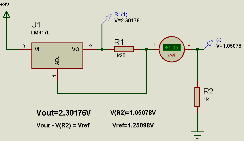

I want to use a 40 volt battery to supply current to perform electrolysis. The circuit uses 5 NiMh 9 volt rechargeable batteries in series and a current regulating diode (I bought 4 X Siliconix J500 0.24mA current regulator diode from a popular auction site). I have looked at the LM723 datasheet, but I'm unable to decipher it well enough to be able to tell first, if it can be used this way, and secondly, what the circuit would look like.
Would this be a good idea? Should I just buy more diodes of the .5ma , .75ma, and 1ma that I want to experiment with? Each lot of 4 current regulating diodes is costing me about $15, so if I could learn to use the LM723 (less than $1.00 each delivered) instead it would be way easier on my wallet.
Thanks for your help and time!
you can't use an LM723 since your supply voltage (5 * 9V = 45V) exceeds the maximum continuous input voltage of 40V.
If you reduce the maximum supply voltage to 36V (4 * 9V) you might get down to that current using an LM317L wired as constant current source.
It can put out a minimum current of 1mA. At a higher input voltage than 9V that low output current may not be reached.
You might be lucky getting the output current down to 250µA adding a 5K resistor in series with the 1.25K resistor - being well beyond the chip's regulation curve.
Boncuk

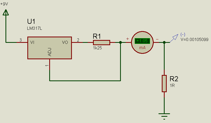

Hi Victor,
you can't use the LM317T for your project.
It's minimum current output current is 10mA!
As you can see from the simulation the output voltage is approximately 1mV at a load resistance of 1Ω. The feedback resistor always causes a voltage drop of Vref (nominal 1.25V). It's power dissipation is 1.25V*0.001A which equals 1.25mW. Use any standard 1/4W resistor.
Of course the value of the resistor in my example must be 10 times higher than using the LM317T at an output voltage of 10mA. The current of 1mA was given in your original thread. Using a feedback resistor of 125Ω the LM317L also supplies 10mA of constant current.
To determine the feedback resistance the formula is: Rref(Ω)=Vref(V)/Iout(A), hence Rref=1.25V/0.001A, Rref=1.250Ω
Here is another example with the load resistor being 1KΩ.
Boncuk
