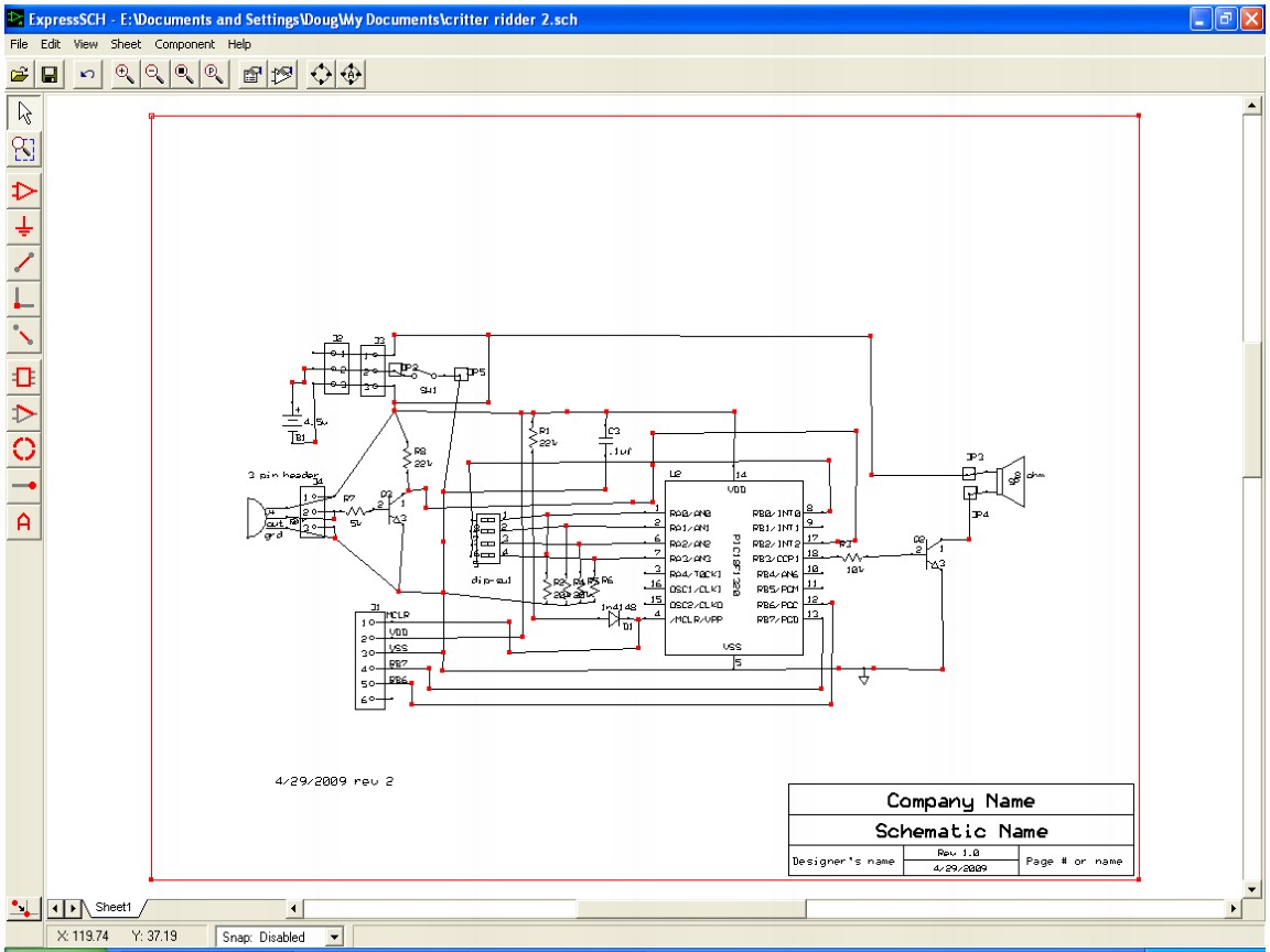

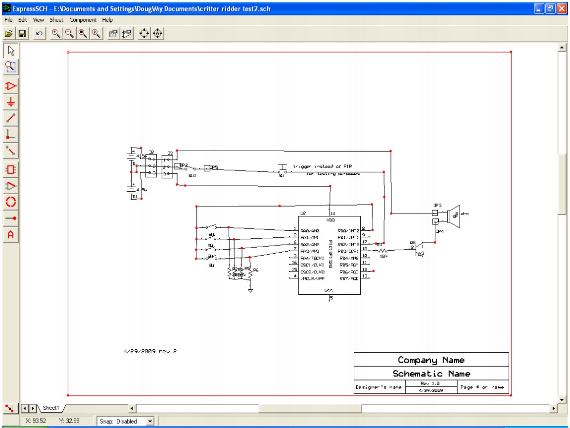

Not real sure If I did the transistor right.

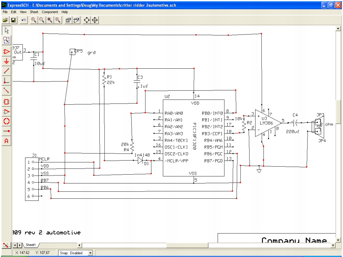

here is both ways I connected the output.both work but is it the best that I hope to get.
the LM386 circuit is going to be mounted on a vehicle to scare away deer from being hit by attached vehicle.

you need to ground the emitter of the transistor for it to work.
You have the pin 14 VDD pin of the PIC connected to -4.5V instead of +4.5V.
Of course the pin 5 VSS of the PIC and the emitter of the 2N2222 should be connected to 0V.
Then when the output of the PIC goes to +4.5V the 10k base resistor has 3.8V across it and its current is only 0.38mA which is the base current for the transistor. The output current of the transistor will be about 120 times more at 46mA. If the signal is a square wave then the 8 ohm speaker will have an average power of 0.004W.
If the base current is increased to 21mA (by reducing the value of the base resistor to 180 ohms) then the transistor's output current will be from 210mA to 420mA and the average power in the 8 ohm speaker is from 0.088W to 0.35W.

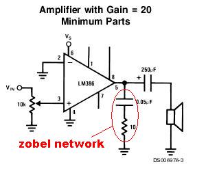

Your LM386 circuit is missing the important parts shown in the datasheet that keep it from oscillating at a high frequency.
.... which are the 0.05uf cap in series with the 10 ohm resistor..... also known as a Zobel network..... you must have these there to keep the LM386 from self destructing. actually you won't find many 0.05uf caps available (shows how old that schematic is) use a 0.047uf (47nf)....

The single transistor makes a very poor amplifier because the value of its base resistor is 55 times too high and the transistor does not have enough current gain.
The LM386 amplifier doesn't work properly because the 10 ohms (not 10k ohms) resistor in series with a 0.05uF capacitor is not connected from its output to ground as shown on its datasheet.
like this...... this keeps the LM386 from becoming an RF oscillator, and burning up as a result....
