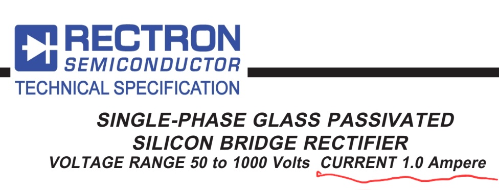

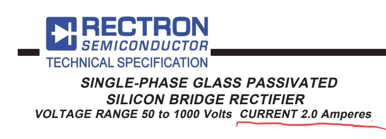

Hi, can I use a DB207 instead of a DB107 do they both work the same or are there any input-output differences?
Dave
Consider that, without some form of clue, no one here knows what you are talking about. Please attach descriptions, datasheets, web pages, etc., for the components / systems / refrigerators, whatever.
ak
These are bridge rectifiers, apparently bog standard and made by many companies. Links to datasheets are here.
The datasheets have two pertinent pages. Print them out and compare.
DB107S Datasheet
DB207S Datasheet
Same but 2 A is better than 1 Amp.

Okay fair call but you did not ask the correct questions I know jack s*** about electronics I am an electrical tech trying to repair something and no one near me does electronic repairs any more so just trying to find out what is best for my problem and I thought giving the part IDs would be enough info looked at the data sheets also mean jack to me

Top of the datasheets. It's not that difficult and you might learn something along the way.
Thanks for that I could see the difference one takes 1A the other 2A just not sure any other differences like a minimum working voltage or if they both worked 1V to 1000V no experience

In this case voltage is a range (50 to 1000 volts) and current is maximum. So you can use either if below 1A.
In a lot of cases (transistors etc.) both tend to be maximum. You can use a 50V 1A transistor at 12V 200mA.
With power supplies voltage is fixed (say 12V) and current is a maximum. So if you've got something that needs 12V @ 100mA (0.1A) then any supply that's 12V and at least 100mA (even 10A) will do.

Yes many thanks indeed it is what I was looking for have a DB107 fitted I think it has failed as the board has stopped working was hoping to upgrade to a DB207 but it only has a 12v AC supply so did not know if the DB207 would work but from what Mike says it should do so will be fitting a DB207
