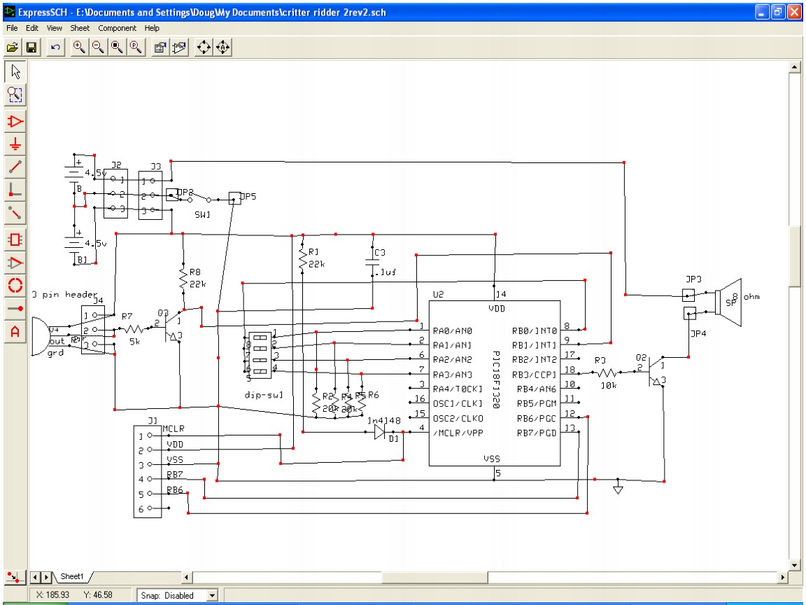

using an LM386 amp connected as a 200db gain how much wattage (speaker is 8 ohm or the transducer is as well).
output is a 5v 18f1320 PIC
presently using a .2 watt speaker but set up with 20db gain
plan is to power the LM386 either with 5v or 12v (going to be used on an automobile.)
If I can locate a higher wattage speaker that is under 1 1/2 dia or a transducer.
never used a transducer before so not real sure of usage.
needs to be water proof
pui audio is sending some samples but still would like to know the calcs behind db gain vers wattage etc.

would a transducer be better choice???

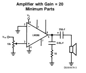

with a square wave output going into the LM386, use a gain of 20, and adjust the pot for an overall gain of 1 or 2. any more than that and it's not really doing anything, since you'll be clipping the amp anyway. shown is the minimum parts, gain of 20 circuit from the datasheet.

it's actually very simple..... input voltage (assuming 5V as the supply for the PIC) =5V peak to peak, minimum amp gain is 20. 5*20=100V p-p would be required for "undistorted" output. the LM386 runs off of a 12V supply, so the clipping level is just short of 12V p-p. even if your input were a sine wave, at such a high input level, you would get a 12V p-p square wave out....
Look at the datasheet for the LM386 amplifier. With a 12V supply, it cannot provide enough current to an 8 ohm speaker for 12V p-p output. The output at clipping is only 6.5V p-p and nearly half the power supply voltage is wasted by heating the IC.

The basic voltage gain of an LM386 little amplifier is 20 times, not 20dB. A voltage gain of 20 times is +26db.
The LM386 can have a voltage gain of 200 times, not 200dB. A voltage gain of 200 times is +46dB.
When does an amp clip?
The output of the amplifier clips (squares-off) when its input level is too high and its output cannot increase any more because of the limited voltage of the power supply.
If an amplifier is severely overloaded by a load resistance that is too low then the output current will try to exceed the max allowed output current and either the amp blows up or it will limit the current safely but cause severe clipping distortion.
