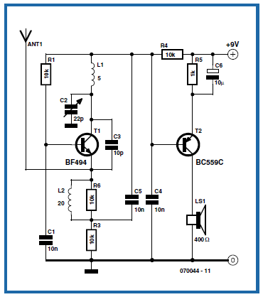

this is actually an AM detector. it works as an FM detector by what's called "slope detection" where the receiver is tuned offset from the center frequency, and the slope of the frequency response of the detector translates the frequency variations of thr FM signal to amplitude variations. slope detected audio from FM is usually somewhat distorted.
Hi, I simulated the circuit. Others are good (I think) but I didn't see good audio sine wave form by 64 ohms speaker. I used 2K and it was very good sine. Please run this file once! Won't it work with general sensitive earpiece like 64 ohms?
Warn me if other arrangements are also not good please!

I with 64 ohms speaker, audio waveform is not good. I added 220 ohms series resistor with 64 ohms speaker then It has very good 100mV peak to peak audio output. Please test once.
I want to request to audioguru to run this file (attached on previous post) please!
The circuit has no audio modulation, it is simply an RF oscillator.
When I simulate it I get a very low level sine-wave at 100MHz, at the collector of the BC557B.
The BC557B has an emitter resistor value that is much too high for it to have a collector load of only 64 ohms.
Also with a collector load of 64 ohms then the base current must be much higher.
I added 220 ohms resistor series with 64 ohms speaker and got 100mV sine. I don't know what it is.
Can we modify simply and make it workable little? Or should I have to leave the project?
Why don't you use a little audio amplifier IC to drive the 64 ohms speaker or headphones? An amplifier IC does not wrongly put DC into the speaker like the single BC557B transistor does.

it's a super-regen receiver shown without the antenna connection, which makes it just an oscillator..... the base of the oscillator should have an antenna coupled by a capacitor, but whoever drew the original schematic forgot to include that little detail.... which makes it either an "easter egg" to force you to buy the kit, or an obvious "oops" that should have been corrected. the OP should also keep in mind that super-regen receivers are banned in many places, because it bleeds RF back through the antenna, and becomes an "unintentional radiator"......
To AG- I wanted to make smaller device so didn't tried additional Amp. But if it is necessary, I will add.
To unclejed- I am little confused here, you said 'add an antenna on base using coupling capacitor' But I think RF of base has been grounded with 10n cap, isn't it? If antenna signal is grouned, how it can receive FM? (I guessed 10n won't ground 100MHz, will it?)
The antenna for a super-regen "radio" is usually connected to the emitter but sometimes to the collector since the base is grounded by a capacitor.
The simulation will not show audio since the RF is not modulated.

I made a regen-FM radio today. Yes as you said the selectivity is extremly poor and stability is extremly BAD. I guessed it's a toy!
