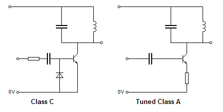

A diode isn't essential but it is often used in RF class C amplifiers to make them easier to bias to class C.
Anyway it doesn't have to be a class C amplifier, it could easilly be a tuned class A amplifier.
Well neither of those two diagrams were correct, as they didn't include any biasing components - the 'class C' one should have a single resistor where the diode is, and the 'class A' one should have either a single resistor from base to positive supply, or (preferably) a potential divider feeding the base. The emitter resistor should also have a decoupling capacitor across it to prevent heavy negative feedback.
But in any case, this is a tripler, you don't want class A, you want class C - easier, simpler, cheaper, and FAR more effective. Where you would use class A is in a linear amplifier (no multiplication) such as an SSB transmitter.
I admit my class A amplifier schematic is wrong, you are right. There does need to a biasing potential divider at the base, and an emitter resistor bypass capacitor is used for some applications but not always it depends on the bandwidth and in this case it would be recommended too.
There is nothing wrong with my class C scematic a diode is often used, it does help to control the duty cyle.
