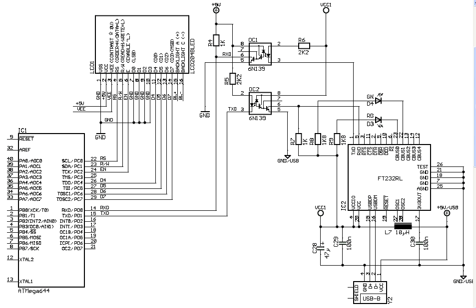

I suggest to use optocouplers. 6N139 have an extremely low forward current for the transmitters (0.5mA) and can be connected directly to the AVR µp.
That way you might keep USB ground and VCC separated from your device.
I'm using this setup for my DDS-function generator without any problems.

I wouldn't do it in that particular case. (connecting all grounds).

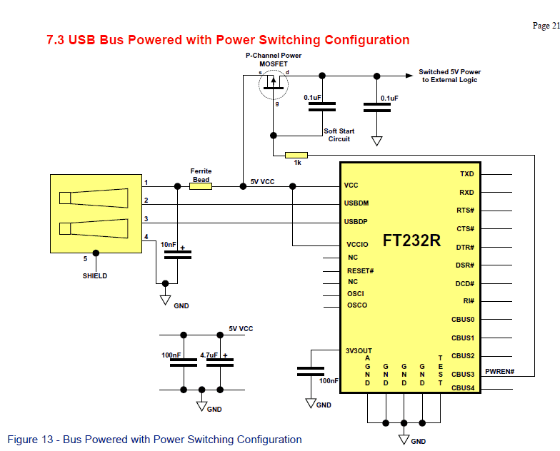

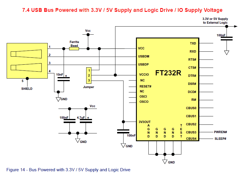

Here are two examples to power additional devices using USB power.
The FT232RL has to be initiated in both cases!
There should not be a problem connecting circuit ground and USB ground as long as there is no possibility to "create" ground loops.

I think the better Way is to power the FT232R by the USB Port.
So the FT.. can always be initialized by the PC.
When you power the FT232 by your internal Power supply it can only work if this power is present.
The next Problem - Boncuk has described that already - is the possibility of ground loops.
When your device is connected to the PC and that device has Connections to other components that are conected to the PC, it is possible that the GND is tied together through the whole system.
At measurement equipment it is possible to get wrong results, or damaging of some parts.
I've made that experience with my LiPo Volt Meter.
There was a Charger with RS232 and the LiPo Voltmeter with USB both connected to the PC. First there would be shown wrong results. Then the A/D Converter of LiPo Voltmeter was blown. After installation of optocouplers the problem was solved.
When such one is planned in your case, you should use optocouplers to get galvanic isolation. The easyest place to do that, is at the TxD and RxD Connections between the FT232R an the rest of the circuit.
So the FT232 would be powered by USB and the circuit behind the optocouples has it's own power supply.
