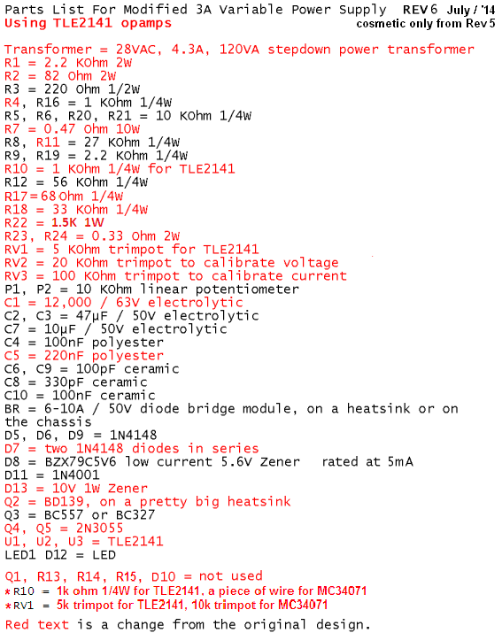

Here is the latest schematic of the fixed power supply.

In my schematic of the fixed power supply, notice that opamp U3 is the only one needing the -1.3V supply so that its output can go negative enough that diode D9 can reduce the output voltage to zero if the current regulator needs it at zero.
U3 does not need its output voltage to go very high so its positive supply pin is fed the unregulated positive voltage through a 10V zener diode to keep the total supply of U3 less than its maximum allowed voltage of 44V.
I show the few changes for the fixed circuit. Some resistors are physically larger and will not fit on the pcb. Look at the value of C1.
The original circuit had a maximum output current much higher than 3A which destroyed many parts. It also allowed the maximum output voltage to go too high so the output was not rtegulated and was full of ripple.
The new calibration trimpots are adjusted so that the maximum current is exactly 3.0A and the maximum regulated voltage is exactly 30.0V.

I come to this discussion exactly as Music Manager did... A novice, wanting to learn, choosing the Chinese PSU kit, thinking it was adequately engineered... discovering that the kit has problems, wanting to fix its issues, and by it all, frustrated. I have read the thread some several times, but I don't think I am following the instructions correctly...
I thought that the corrections to make the kit operational were summarized on Post #34... Accordingly, I have made those changes... However, as I look back through the thread, I think I may be seeing additionally needed changes. Audio Guru, would you please make a single, complete list and schematic for me?
I have a 24vac, single secondary transformer. It is producing ~25.5vac from 110vac/60Hz mains. That's about 32vdc, as I recall, after the rectifier.
I am shooting for 0-30vdc and 0-3amps... I ended up with multiple sets of kits, due to shipping errors. The first kit I assembled, without any changes, was producing the target numbers, but with overheating. It appears that a 28vac transformer maybe suggested...
Additionally, I will be changing the fan voltage regulator to a 7812. I have a 40mm fan and heatsinks for cooling...
The 12K cap is huge... I will bodge it onto the bottom side of the PCB...
Thank you for your help!
Hi T1d
There is exactly that at post #41

You sent me a revised schematic and parts list for the chinese PSU kit I built which I kept with the intention of building at a later date. As you can see, a question was posted about the kit and modifications today which reminded me I must get on with building the new PSU.
I have one question .. .. .. are your modifications intended to fit onto the PCB that comes with the kit or should I look to make a new board ?
S
The Chinese pcb is different to the circuit I worked on so you should make a new pcb. There are a few people who designed a pcb for my corrections in the forum at https://www.electronics-lab.com/ where the original defective Greek kit was a project.
