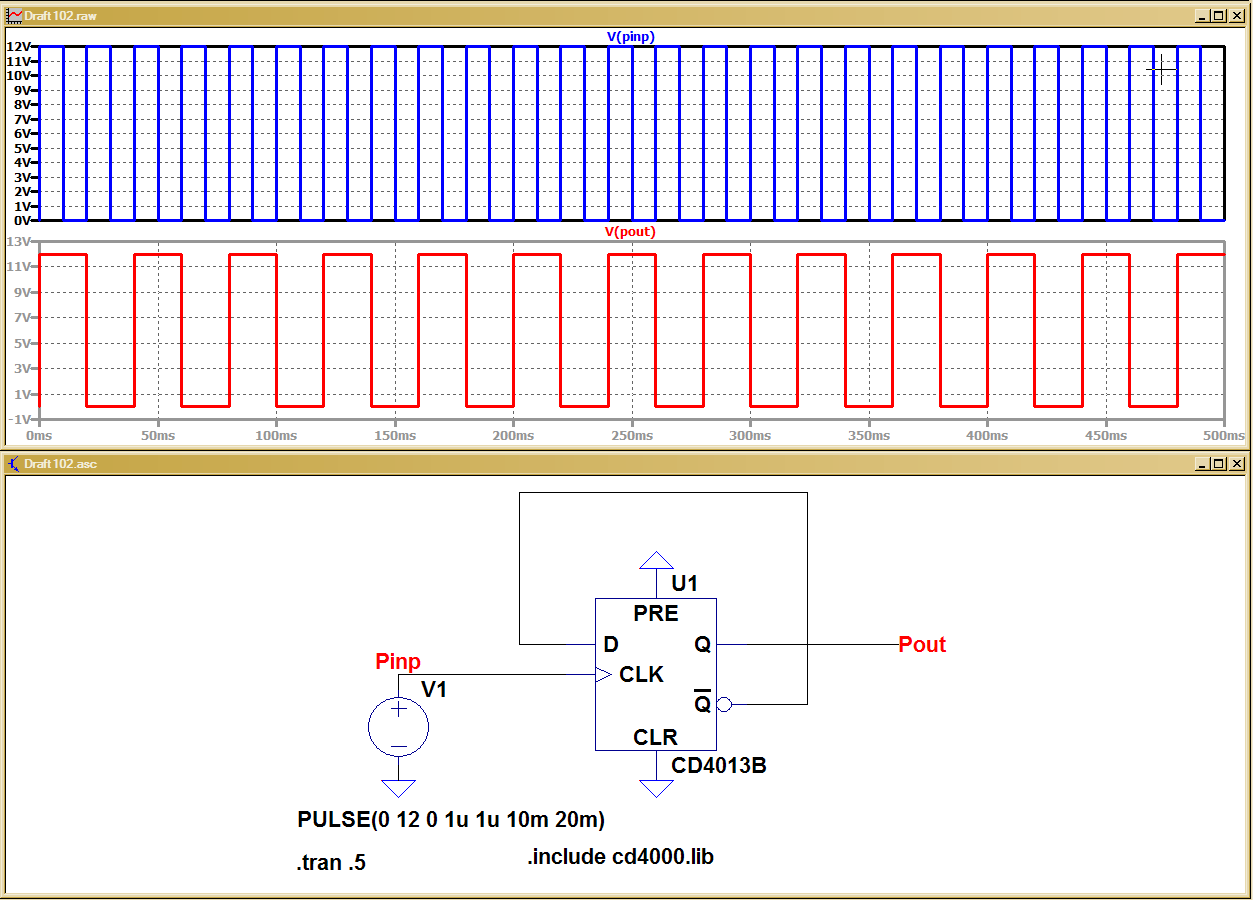

A 12v old (1988) boat speed indicator with its paddle wheel sensor. I have a new display which can read the old paddle wheel but interprets the speed at close to twice the proper value. Calibration on the new display is limited to about 15%. I guess the paddle wheel sends a signal each time a paddle induces a current.
I think if I can find a way to lose every other signal from the paddle wheel then I can use the two together. Such a circuit doesn't sound too complex - is this something I can buy? Otherwise could you give me some pointers, please?

This could be achieved by using a bistable IC, [ divide by 2 ].
What's the voltage level of the paddle pulse.?
E

I only have a multi-meter; 5.04v when not in use; varying around 2.6v to 2.7v when the wheel is in motion.
If the paddle pulse is +5V at rest, could you check that the pulse goes to around 0V as the paddle rotates?
You will have to turn the paddle wheel slowly by hand while checking with your meter.
If we can detect a 5V and 0V pulse it will make the circuit simpler, if not and its only 2.5V minimum [ not 0v] you will need a little extra circuitry.

Paddle wheel cycles from 0.01v to 4.98v using my 12.42v dc supply off my motobike battery. Each 360 deg. rotation produces 2 5v signals.
Eric,
Taken a lot of learning, and unlearning too! Gone from a full flashing light version of 34 components to my simplest of 4 components when I understood what an inverter might do. To my total surprise to it works! Thank you so much for pointing me in the right direction.

For the 'noise' try adding the components shown in this marked up image.
The PCB lacquer should be fine.
