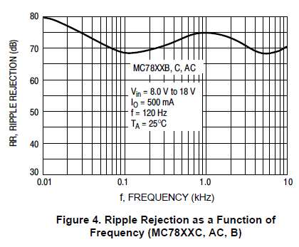

I have use something almost like this to see the frequency response of a power supply. Example; 15 volt + 0.5V signal. Sweep the signal from dc to (khz or mhz) and look how much of the signal gets to the output.
This is how you measure supply ripple rejection on op-amps. OR Look at the LM7805 data sheet. There is a input to output rejection ratio.
I also use this to see if the error amplifier is stable.
