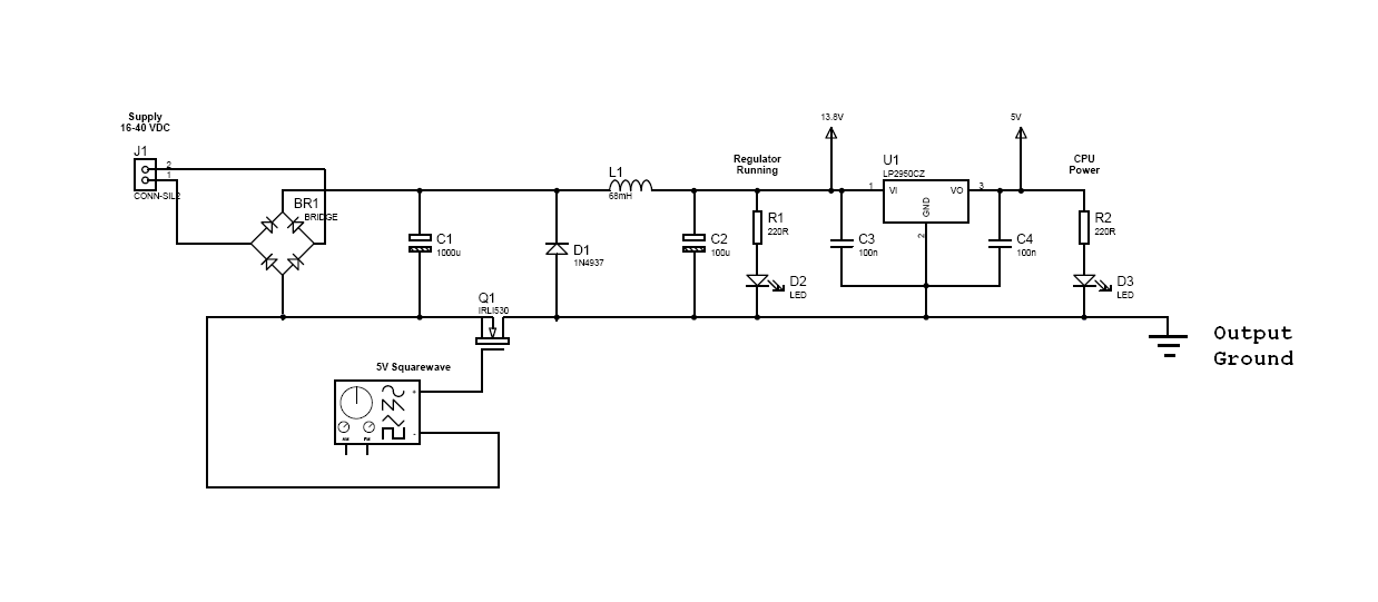

I want to use a buck converter to convert a voltage input of 16-40v to 13.8 v. this will be controlled via a 16f628 via pwm.
The buck converter part is where my problem starts.
I am trying to make a buck converter using a logic level mosfet but seem to be having problems with the switching of the mosfet.
according to the spec sheet a logic level mosfet will switch on VGS(th) at 2V.
I have calculated the the buck converter to use the following components.
switching freq = 700kHz
induc ripple ratio = 0.3
capacitor voltage ripple ratio= 0.04
Max overshoot= 0.096
Max current = 500mA
there fore the duty cycle = 0.44
min inductance = 63.4 uH
Min Saturation current = 0.69 A
Min out put capacitance = 11 uF
when in practice the output current is way less than 500mA ie: it barely turns on a led also the voltage mesured across the output terminals is about 2V.
I have uploaded the test circuit here
at the moment i am using a function generator to produce a square wave.
If I use the TTL output on the generator then the circuit does not run, the TTL output is 5V .
If I use the normal output and increase the output to 10V then the circuit runs but with limited current ie: nowhere near 500mA
Please help

You have an N-FET in your circuit. If the desired source voltage is 13.8 then the gate voltage needs to be at least 15.8V (i.e. 2V more than the source voltage, since Vgsth is 2V) before the FET even begins to turn on (conducting only microamps).

I'm sorry i did not see the dot that connects the sig generator to ground. So you are driving the gate with a signal genrator in a normal fashion. In that case 5v is not enough as you now know, but maybe you could look into using a P mosfet.
Ok my understanding is that a logic level gate drive should be able to turn fully on with 5V?
Correct. But that 5V must be between gate and source. In your circuit the 5V from the sig gen is between gate and ground.
ok so I have 2.8v between gate and source so how do i fix it?

To turn on the N-MOSFET you could use a bootstrap driver.
To turn on the P-MOSFET you could use an NPN transistor buffer from the processor with a resistor to V+. You need a low value resistor for fast turn-off of the FET or a two transistor push-pull driver for faster switching.
