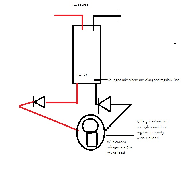

Hey Long story short I am building a simple power supply. When I add diodes on the output of the buck boost converter I lose regulation on the output UNLESS I have a small load attached. I dont really lose regualtion but voltages start at different levels. Example supposed to be 12-65v, after diodes its 48-99v. but its not a real voltage its like floating. ( BUT if i measure before the diodes on the converter itself regulation and voltages is fine)
So with diodes on the output the Buck Boost converter has improper regulation unless there is a small load. With a load all Regulation is restored normally with correct voltages. I have tried many converters and many types of diodes including schottky diodes. Why is this happening? are my diodes not switching fast enough? I just want diodes on the output for spikes/reverse charge. I just don't get how adding diodes on the output is effecting the regulation. The only thing i can think of is I am messing with the DUTY cycle feed back or something? I was thinking of just adding the meter on the converters output before the didoes to see the proper regulation without a load? please help lol

The input is straight 12v. The output one diode one way and another the other way. The Diode choice was a 10 amp 1000v diode. I tried other ones too.
About the small load? sorry for my newbie question but What Load can I put that would variate with the voltage and would not overheat? I have no problem putting a load, I can't think of anything that would work with the voltage ranges. ( that is easy to install and doesn't take up space). I intially thought a power resistor but wouldnt I be getting tones of heat on higher voltages or vise versa on the lower end depending on what resistor i use?
Its a poor diagram but maybe it will help what I am trying to say.

Are the didoes supposed to effect the output variation? are they not the right ones? is that even a thing lol
I think your getting a measurement anomaly.
The diodes might be allowing peaks through which your meter is reading.
Why do you have diodes on the o/p?
Its not uncommon for an smps to have a minium load, some control ic's have a minimum pulse width so you need to load the supply enough to shunt this much energy.

Dr pepper you nailed it. I used a different meter and all works fine. In the end it was my meter only picking up the peaks. Thank you !
To answer your question I am using diodes on the output to make sure I dont get any spikes/unwanted voltages when charging or using a motor. Is this not the right thing to do? I am genuinely asking.

You dont need the diodes.
But if you want you can put a diode across the motor in reverse bias, ie the cathode (silver stripe) goes to the + end, this will clamp any noise to 0.6v.
Your expensive meter is telling the truth, where as the cheaper one is ignoring the peaks, this is to be expected.
