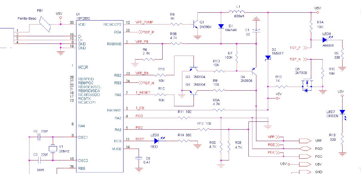

Yes the 18F4550 will work, and don't build the brenner8. Instead build a PICkit2 clone (nearly the same amount of parts and a far far better programmer and debugger with MPLAB support etc, etc...)
You can use the 18F4550 in a PICkit2 clone too, I did.
Prototype PICkit2 compatible using a 18F4550

It's in the Junebug manual, just build the top part above the green line in the schematic.
You can omit the 2N7000 and the BS250 (jumper the D & S) if you want to keep it simple.

Just skip them, the BS250p can supply 230ma both are used only for VPP before VDD and is only needed in some situations.
So for now just place a jumper across the DS250 D,S When you can get a BS250 then solder one in.

my device "pic18f4550" not detect , it say "pickit 2 vpp voltage level error .
check target & retry operation" .
but note i change the 2n3906 by bc557 and the coil with another one " i dont know its value but its like the capacitor in size "
so what can i do now ?
any idea
Well that's the problem. 470uH thru 680uH should work, but the coil is important. The BC557 should be fine. The VPP cap can be 22uF thru 47uF.
A too small inductor won't work.

Please ensure the pinout of the transistor BC557 , as it's collector and emitter are reverse.please check this aspect.
