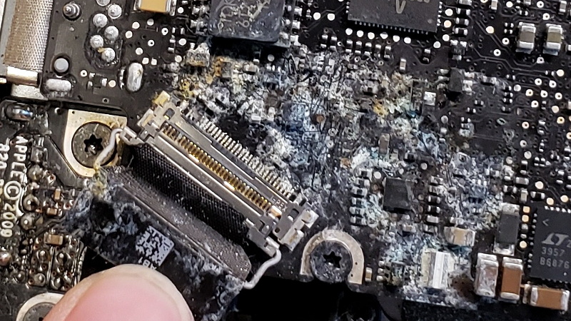

Once a piece of electronics gets wet while it has power on, parts with moisture and voltage start to electrolyse, forming metal salt deposits on the surfaces - grey, brown or white "mould" like stuff.
That is conductive and also hydrophilic, like table salt or sugar; it will collect moisture from the air. The metal salts can also react with carbon dioxide in the air to form carbonates and "grow" over time.
The only way to cure such damage is to dismantle the device and clean off all such deposits using deionised water and then alcohol.
If the carbonate build up is bad (rather similar to limescale texture & not very soluble) that can be removed by scrubbing with white vinegar before extremely thorough rinsing with deionised water, then drying and washing with alcohol to absorb residual moisture.
That can work, as long as the short circuits caused have not destroyed parts and the corrosion has not already eaten away conductors or component pins.
The most critical thing is to remove power (e.g physically disconnect the battery) as soon as you realise anything has got wet. The longer it stays connected, the more damage occurs.
This is typical of what water ingress damage looks like:

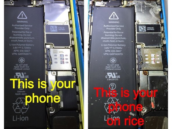

ps. For anyone else reading this - putting phones etc. in rice to dry them is completely ineffective.
Dry rice is a reasonable desiccant, and the air between the grains will be very dry - but the moisture that must be removed is contained in a mostly sealed enclosure and with no airflow, it can take days for the moisture to migrate out of that casing - with the corrosion and damage worsening all the time...
If you cannot dismantle the item or immediately take it for repair, heat and airflow are the best ways to dry it out.

OK. Well, sounds like I might want to (delicately!) see if I can expose the works and try the alcohol sort of treatment. Or see if there is a shop or service around here that might try such a plan.
I take it the piece in the photo above is not meant to be taken to a shop, but rather dropped in the waters off Antikythera.
You might struggle finding anyone, first off most engineers won't look at Bose gear, it's just cheap Chinese gear with a big profit margin, and no spares or service information available - and Bose are particularly unhelpful.
Then water damage?, it's usually impossible to perform a 'professional' repair, so again many won't bother as it just harms their reputation. You might get it working, but there's no guarantee it won't fail again in the fairly near future - corrosion continues, even where you can't see it.
The picture in post #6 is by no means the worst I've seen :D
