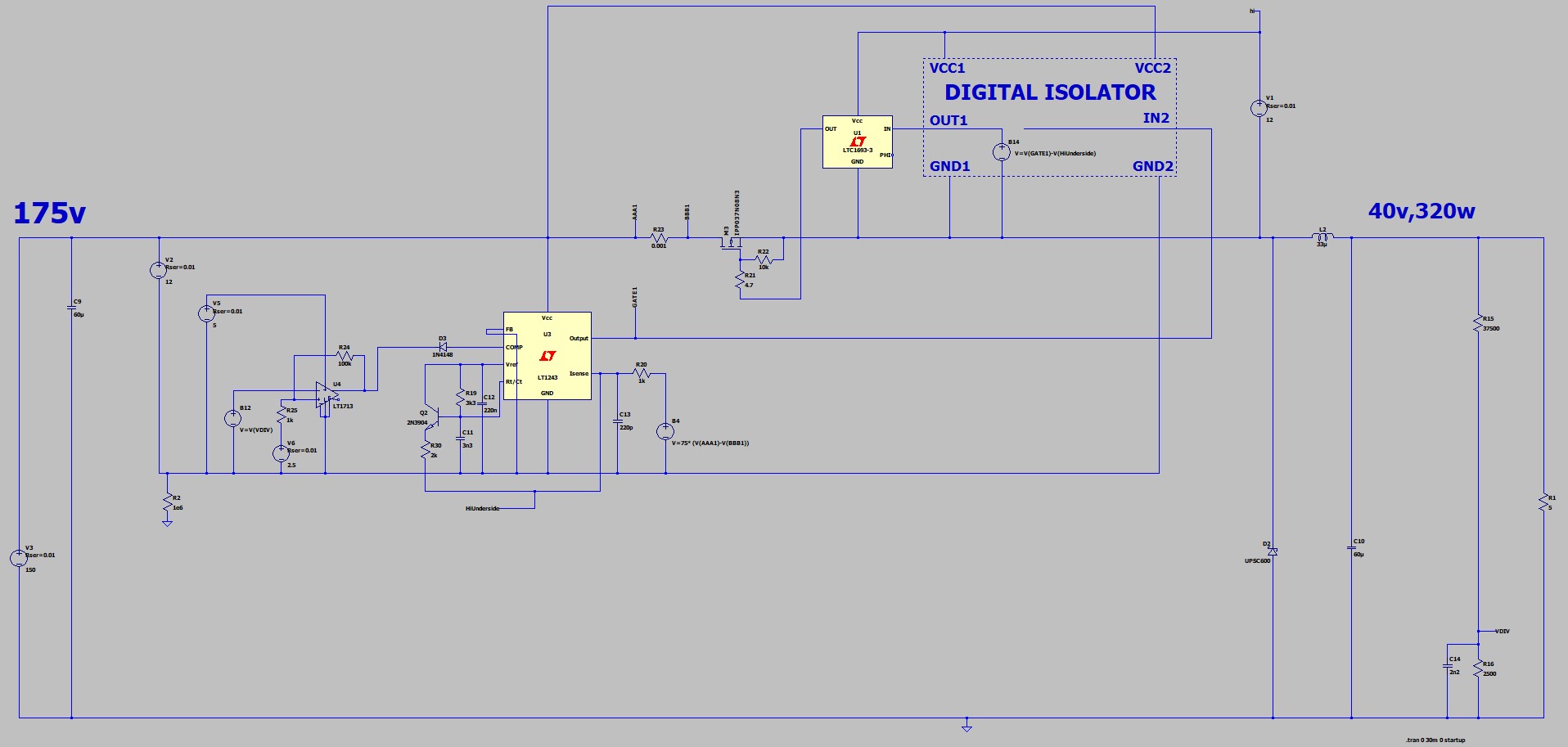

Bootstrap hi side drive chips dont let negative voltages...why do they care?
Flyback

Thanks, yes granted the LTC4440 is only rated to 80V....though my apologies as its the 2ED2182 (650v) that we will end up using, as its says on the schem above.
So it seems that a bootstrap driver cannot be used here.....though i suspect that we may use a digital isolator chip instead to level shift the gate drive signal...then shovel that into a hi side gate driver.
Would you agree?
Also, AYK, We cannot use a pulse transformer as we sometimes will need the FET to be held on for several hours.
I am amazed theres nothing offtheshelf for this, as driving a buck fet from such a high "Underside" is common, eg with pfet buck drivers, which need converting to nfet drive.....the hi "underside" being needed as the pfet driver needs to connect to a hi side sense resistor.
There is nothing wrong with correctly using an appropriately rated bootstrap style driver.
Thankyou, indeed you have kindly implied that in proper useage they are used in the low side and the hi side fet they drive is in the hi side...ie thats the standard way to use them. As in the top schem, this modus operandi is unfortunately not available to us.
As such, we wonder about the attached configuration instead? Using a digital isolator....one that cares not that its GND1 will fall more than 100V below its GND2.
Would you back the attached, may i ask?
LTspice and jpeg of alternative modus operandi as attached
The digital isolator used would be eg ISO7810

Why? There is no requirement to use the low half of the driver, the two parts are separate and have individual inputs.
Thanks, yes you are right, but if you see the application of post #1 and #6, you see that standard bootstrap drivers simply cant be used......we need to drive a hi side Buck FET from that "hi underside" rail, as shown.
The upper half of an IR2110 should work fine
The only allowance you would need to make, as the load does not have an active pulldown as with a half bridge, is a supply to feed between Vs and Vb.
eg. It could be a 15V zener + cap from the Vs pin, fed from a bias resistor from the input to give a floating supply above Vs, the FET source voltage.
Or, there is a floating charge pump version on page 18 of the app note:
(Different driver IC, but the same principle).
Supply the VCC pin with an appropriate voltage relative to COM (Power circuit 0V), even when the lower driver is not in use.

..Thanks, I think we have confirmed that Bootstrap drivers are no good for the example shown in #6.
Do you think a UCC23513 based solution would be OK though?
UCC23513
I am wondering how they drive fets in totem pole PFCs, as they often have a similar kind of setup to that which i show in #6 (ie fets being driven ultimately from a rail "above" them.)
They can stand Vs being as low as -5V with no effect.

Bootstrap ICs are out of bounds, as you kindly helped me to understand....
A big Thankyou to RJenkinsGB for excellent info leading to the conclusion of "Bootstrappers being out of bounds" for us here. This is now seen to be correct.
...So then you get into the "OK what else can we use?" frame of mind......then you start thinking, "why on earth are bootstrap ICs so popular when they have this kind of problem?"....and "do any other isolated gate drive methods have such a problem?" (we hope not).

Thanks, no you were very helpful, Bootstrappers can only be used when V(isolated ground) is not deliberately getting driven below V(ground)
As can be seen in #6, this is not the case.
I suspect that you are possibly thinking that we could drive the NFET from the true system ground....that is indeed what a highly competent engineer , as you are, would indeed think........and that is where i am saying no we couldnt....for reasons that would take a long time to explain.......ill have a go at making it brief for any reader who is interested....So, its an LTC7860 surge buck which normally drives a 200V PFET....but we want to use it to drive an NFET instead.......as you can tell, if i try to explain more i am going to bore people away from the thread.

As to your not wanting to use a bootstrap for the gate drivers have you though of adding a DC-DC convertor?
"""s to your not wanting to use a bootstrap for the gate drivers have you though of adding a DC-DC convertor?"""""
Thanks, good point,...hi side power supply plus digi isolator sounds like a plan.
