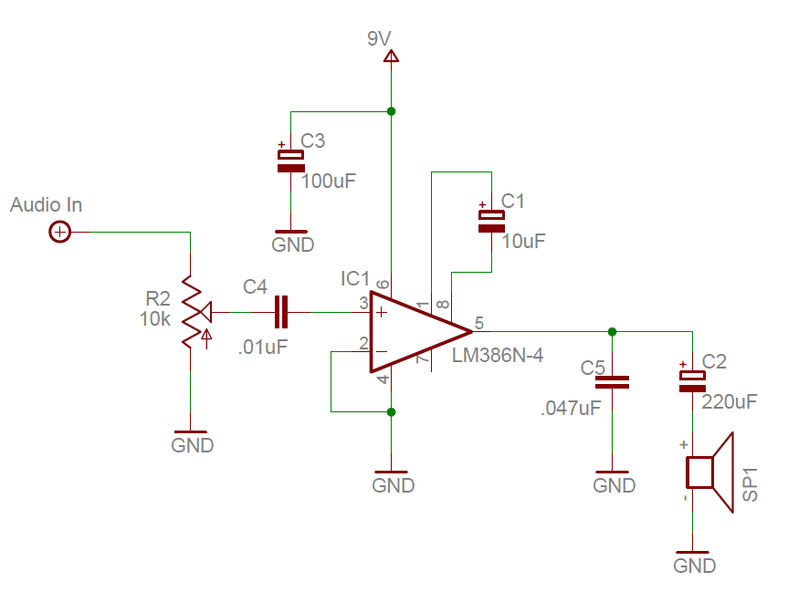

Boost sound from Raspberry pi
When I connect the Raspberry Pi (running the Linux application Mplayer2 streaming music or playing an MP3 file) to the phone system and I put a phone on hold, I hear next to nothing, I just barely distinguish that music is playing.
When I try to connect an 8Ω speaker directly to the analog output of the Pi I am getting just a little more volume as with the phone system. Since I do not have access to the phone system I am testing with the speaker. I figured it was close enough.
The phone system in question is a Norstar ICS 4.0 and from its manual it indicates the folowing:
External music source (customer supplied)
The music source can be any approved low-power device such
as a radio with a high-impedance earphone jack. The
recommended ICS input level is 0.25 V rms across an input
impedance of 3300 Ω.
My objective is to reach he maximum volume possible with no distortion and from this I can control (reduce) the volume from the Mplayer2 command line application.

The LM386 should have worked with 5 volts. Since you have a scope set the output to .25 volts. This won't be very loud into a speaker, but might be loud in an earphone or phone system. While your at it measure the input from the raspberry.
Yeah actually, it really should have worked. It should work with the Pi honestly, as 0.25 V RMS across 3300 Ω is not really very high demand. Shouldn't the Pi easily be able to output this? I wonder if the input to the phone system is not somehow damaged and drawing more current than it should be? Then again, I don't really know for sure.

I am trying again with the LM386 at 5V and the volume at 1/4 the sound is quite bad, sounds like a train + and distortion.
Do I need a tone generator to measure the output from the Raspberry Pi? using music it keeps changing.
Edit: Maybe my values or something is wrong?
This is what I have:
I think I have found why the sound is so bad...
I am using LM386N-4 and according the the datasheet Min = 5V
The RasPi is delivering 4.8V
Perhaps I should use LM386N-1 which requires Min=4V ?

With the capacitor from 1 to 8 your gain is 200 so the output is probably clipping even when the pot is close to 0. You might also put a little resistance in series with the cap on the output. If you don't have 10Ω use 4.7 or 15. When you scope the output the voltage swing should be below 4 and above 1 or it is still clipping. The input should be less than 0.2 volts peak to peak. With those 2 numbers you should be able to set the gain correctly.
Yes, the -1 part is the right one but the others will probably work.
Remove your C1. It makes the gain way too high.
Add a 10 ohm resistor in series with C5 as shown on EVERY schematic in the datasheet of the LM386. It might oscillate without it.
The 220uF capacitor C2 is calculated for an 8 ohm load. To feed the 3300 ohm input of the phone system it should be 0.47uF or 1uF.
If you built the amplifier on a solderless breadboard then it is probably oscillating and distorting due to the high capacitance between rows of contacts.
With a 5V supply, the maximum output without distorting of an LM386 into a 3300 ohm load is 3.8Vp-p which is 1.34V RMS which is more than enough.
Ok I've removed C1 and that took a chunk out of the speaker volume as I went from a gain of 200 to 20, I added a 10Ω in series with C5 (that didn't make a difference but it is there now) and when I replaced C2 with 1uF the volume in the speaker is the same as if It was plugged in directly to the Pi (to my ears) I guess due to the speaker being 8Ω and the output now configured for 3.3k so I will solder everything like this and test it on the phone system hopefully this weekend.
Thank you all for your help.
Mike
I tested on the phone system and using 5V (from the Pi) I had to leave C1 and keep C2 at 220uF. Somehow I figured the 3.3k spec I read in the manual was either a min or a max or I simply had the wrong manual.
What I hear on the phone system is exactly the same as when I plug an 8Ω speaker.
Something I was not comfortable with was the volume generated distortion at less than about 1/4 of the way. I added a 100k resistor in series with the audio input and it now performs better, distortion starts at 3/4 up.
I have everything soldered and enclosed in a plastic box.
I still have a 4Hz low sound that becomes noticeable only when the music stops, I can live with this but if I had a fix it would make it perfect!
Since you needed to use a 220uF output capacitor on the LM386 amplifier then the input impedance of the phone system music-on-hold must be 8 ohms, not 3.3k ohms.
You might need some big (maybe 47Ufd.) filter caps on the supply voltage and pin 7 to eliminated the "putt putts'. If you need more output without distortion it sounds like a 12 volt wall wort is in your future. :D
I tried adding a 47uF cap between pin 7 and ground, also tried between pin 7 and +5V and tried to add a 220uF between +5V and ground and it didn't make a difference. It sounds like a choo choo train when the volume is full down or when the music stops and turning the volume up doesn't seem to make that sound louder but when I stop the Mplayer service the sound stops so it must be something else but it is not noticeable when the music is playing so I can live with this.
