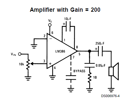

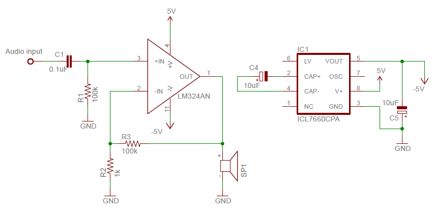

Using the LM386 would be a great solution only I have to supply it with 9V and then reduce to 5V to supply the RasPi. Since I want to have the final product enclosed in a plastic box the heat is the only issue.
Knowing that the LM386 amp solution works perfectly to solve your sound problem, I would say you should let sleeping dogs lie, and move on to deal with the overheating problem, as that's a whole lot easier to fix.
