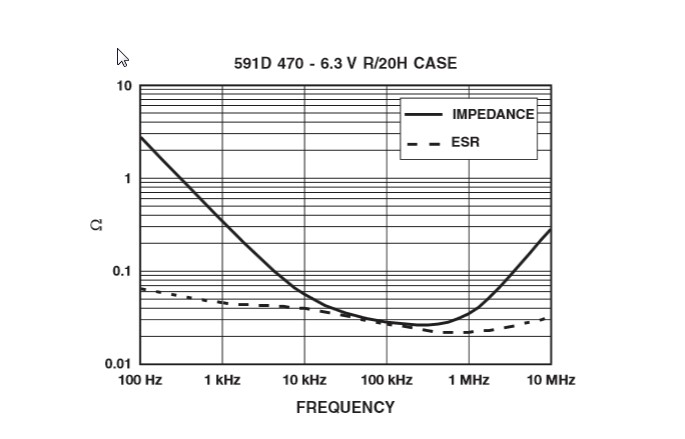

I'm not telling you how to think, I am telling you how the LM2731 part works. I am the guy who took the data on resonant frequencies for the elect caps. I recall the resonant freqs were in the 400 - 600 kHz ballpark for this size parts and that means if you use them on a switcher clocking 600 kHz they will not look capacitive, but they will ring like a resonator. Some will be functional but output noise will be severe. Guess how I learned that. You can use them as bulk capacitance in parallel with a ceramic cap. As for the 1.6 MHz switcher part, I couldn't count the number of calls I took from () who could not understand why they didn't work with Tantalum caps despite the fact the switching frequency was higher than the resonant freq of the cap which means the "capacitor" actually acted like an inductor at the switching frequency, hence not functional. It would have been better if, as I had urged, we had simply stated on the data sheet that Tantalums should not be used at all, but Marketing would never allow that and it's not strictly accurate. As long as the correct ceramic cap is present, a tant can be added since the cer cap will supply the switch current and the Tant will do nothing except supply load current during a transient. That was explicitly stated in one rev but I did not have final revision authority.
But we all need to learn so I invite you to fire up a 1.6MHz version of the 2731 and see how well it works using only tiny Tantalum caps (OP's #1 design constraint was overall size). The 600 KHz version MAY be functional with tants depending on the cap if you can stand the noise on the output. But the only thing the 1.6M version did when using Tantalum caps was generate phone calls to the applications support line.

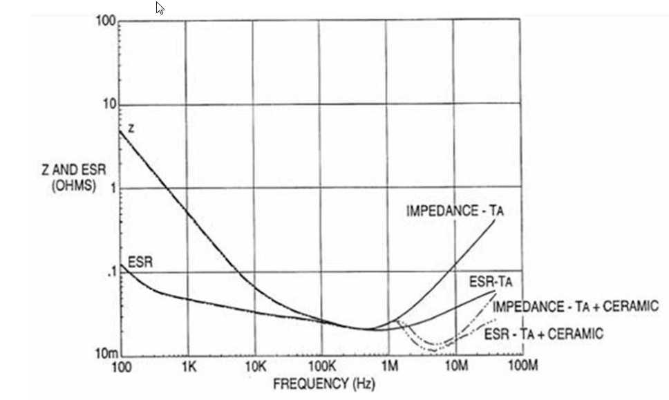

Here is the reason you don't use Tantalums on a 1.6 Mhz switcher. Here is an impedance plot I found on a Kemet low impedance Tantalum cap. It goes resonant at about 500k which means at frequencies above that, it looks inductive (which is why the impedance rises with frequency). The resosnance frequency is the lowest value of the impedance curve.
Notice also that they show an impedance plot for tant paralleled by ceramic that doesn't go resonant until about 5 MHz. That parallel combination would work.
