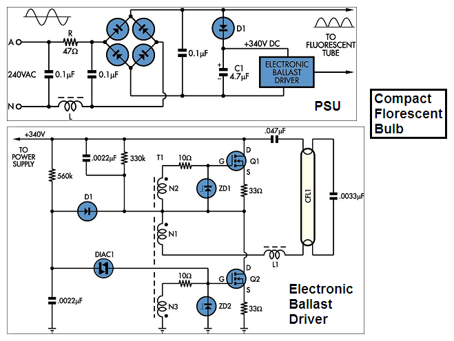

Compact fluorescent light bulbs have a 40kHz oscillator inside. The oscillator is made with many good electronic parts.
There are websites that show the schematics of many models.
Here is the schematic for a compact fluorescent light bulb:
How accessible are these components though? I'd imagine they're at least mostly potted circuits? I've never tried to take a CFL apart before, but if the innards are actually usable I might buy a couple just to examine the internals.

DO NOT break the bulb of a CFL - they contain mercury! You can sometimes carefully wiggle the bulb enough to break the wires at the base and remove the bulb for safe disposal (preferably recycling). You can then pull the base apart to get to the electronics - and replace them with a driver for a proper LED bulb...
Oh just break it, but don't breath it! =) and make sure it's outdoors so what little is in there dissipates away from people/critters. You risk being close to it when it breaks by trying to break the base carefully. The real threat from CFL's and regular mercury lamps in the first place is the mass disposal of them. I work at a small company who disposes of full sized tubes legally by putting them in the dumpster and smashing them. We're a 'small quantity generator' and not regulated under the same laws as larger companies. It's illlegal for larger companies that dispose of multiple order of magnitudes more bulbs to do this though. A single large company doing this is equivilent to hundreds if not thousands of smaller companies and people. Destroying a single CFL for hobbyist is safe unless you do something stupid like crack the tube and try to snort the gas.
I've smashed numerous fluorescent tubes and I've never seen a single drop of mercury leak out from them! I would estimate that even a large fluorescent tube probably only contains a couple of mg of mercury so I wouldn't worry about it,
Broken glass is probably the worst hazard and the phosphor probably isn't too good for you either. You don't always need to break the tube to get at the electronics, just saw round the base and they should fall out.
A large 4' tube contains about 10-12mg for low concentration versions (down from about 50 in the 80's) and a standard Edison socket version about 5mg - which is more than a year's safe exposure. You don’t see it because in the vacuum of the tube, it exists as a gas. Now, you're not going to absorb all of that immediately with a cold bulb, and most will dissipate with ventilation in warm air temperatures. Where it will just be spread over a larger area and persist, or become the even more toxic methyl-mercury, until absorbed by somebody else. It also bioaccumulates in your body, so I would strongly suggest against a cavalier attitude about even small exposures. Some wise counties in the US have outlawed disposing of them in the garbage.
Sceadwain, if you keep smashing those tubes for another 20 years, you will indeed become mad as a hatter. Hopefully for your sake and everybody else's, LEDs will have replaced the Death Tubes long before then.
But I digress, if you do SAFELY (sawing around the base is probably the best option) open the base of the bulb, you may be able to recover usable components, but with the few I’ve opened, most of the components were burned or corroded and unusable.
