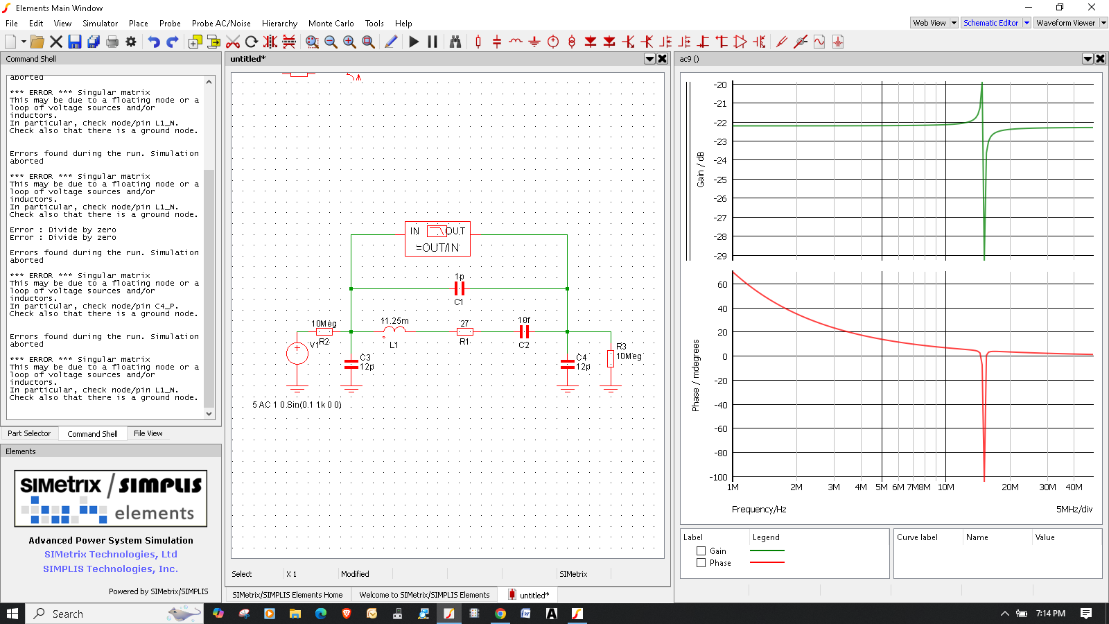

Hello all,
Sorry for interrupting, but I have some troubles with plotting bode.
Namely, the picture below shows my oscillator( he is oscillating properly at fruequency of 14.Mhz for which I need to find the transfer function (draw a bode diagram). I need to get the transfer function of the beta branch to see what it looks like and why it oscillates at 14MHz.
Now, trying, I don't know where I'm going wrong, picture 1 in the attachment is the whole circle, and picture 2 is the B-branch.
Its tricky as you break the loop with your XBP2 setup, so the loading of the input and
output of the freq determining network is not accurate. And you have not shown the
parasitics for the bipolar, like miller C and varies junction C.
That being said you can do an approximation with some assumptions :
1) Look at just the network consisting of the xtal and its 12 pF loading caps. In
simulator drive input to it with a current source, and using hybrid pi model
approximation calculate Zin of the transistor and use that for loading across the
output 12 pF. Then look at sim plots for when the phase shift becomes 180 degrees.

Three differents simulation tools are giving me three different results.. frequency should be around 14.2Mhz.
What am I doing wrong?

The freq is off because the input z does not reflect its loading due to transistor collector.
Same is true for output loading, the miller C generated by transistor not present.
Using just the L and .01pF that resonant freq is ~15 Mhz. You sure you have the correct
values for the crystal model ?

l see, it's clear to me now.
And how will I find the transfer function of the beta branch (my first question)? I get a little lost in the laplace transform.....

But why then my oscillator is oscillating at 14.2MHz?

I still don't undarstand ( for node and branch equations), and I think that's my problem with Laplace.
What is correct node and branch equation for my B branch above?
Earlier, I found this transfer function, for simmilar oscillator:
(1)
where
(2)
C- series capacity of quartz crystal(0.01pf)
Co-paralell capacity of quart crystal(1pF)
C2- 12pF
This is where I got stuck, i will attach ac equivalent with hybrid model here. And some equations that I've done.
At the end I have to find an frequency analytically of my circuit.- to proove where it is oscillating (at 14.2Mhz - calculating the transfer function i suppose)
This Z1+Z2+Z3=0 is the equation from which I need to express the frequency and should get the oscillation frequency, if I'm not mistaken
