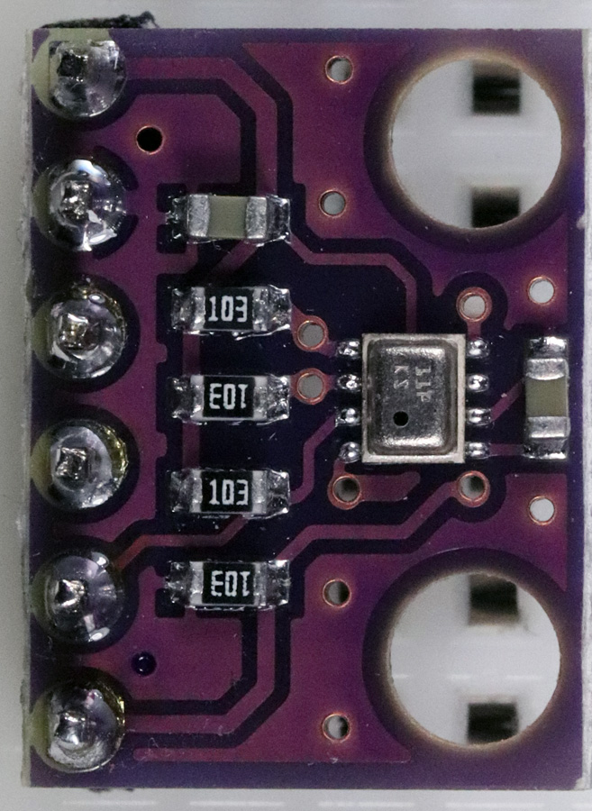

In my case, I bought what was clearly advertised as a BME280 and explicitly stated temperature, pressure and humidity.
Here is the board:
120225

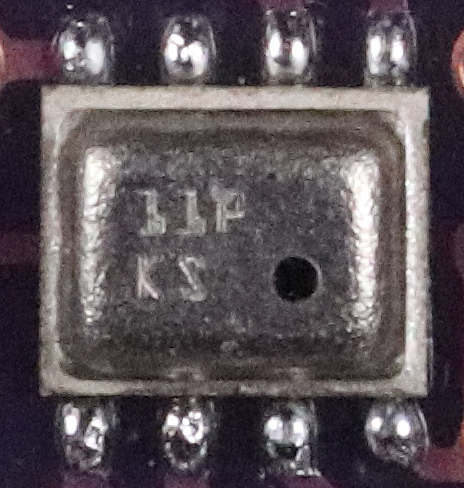

Close up of the component:
120226
That 'KS' identifies the chip as a BMP280 and not a BME280 (see here for links and discussion - I'm not even saying it is a genuine Bosch chip). It gives the sensor ID as 0x58, also identifying it as a BMP280. I went through a similar sequence with software as Pommie Dr Pepper and then did some reading that I should have done before clicking "buy". In my defense, it was only US$1.08, including shipping.

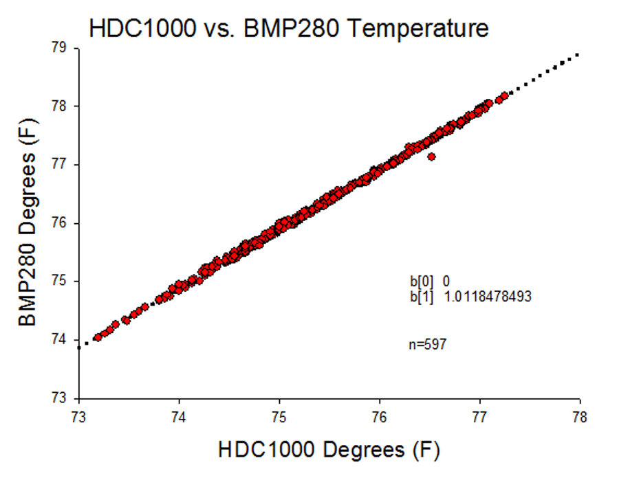

BTW: I have been working on a BLE data logger and the sensor bank (a TI SensorTag) has multiple temperature sensors, including a BMP280. Here is what a correlation between the two looks like over a relatively small range.
120821
Clearly the measures are close to each other with about a 1.0 degree bias - of course that means little alone. I would not mind having something like this handy.

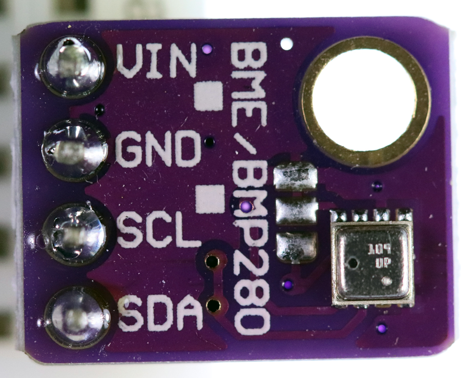

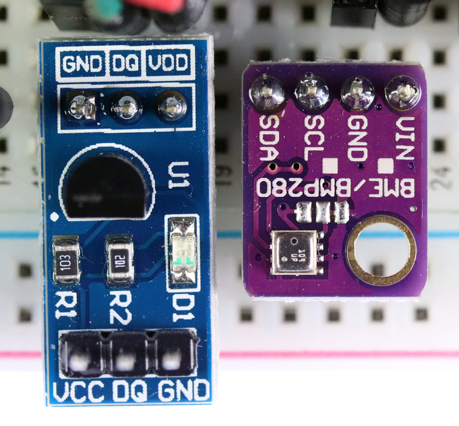

Here is the board:
121022

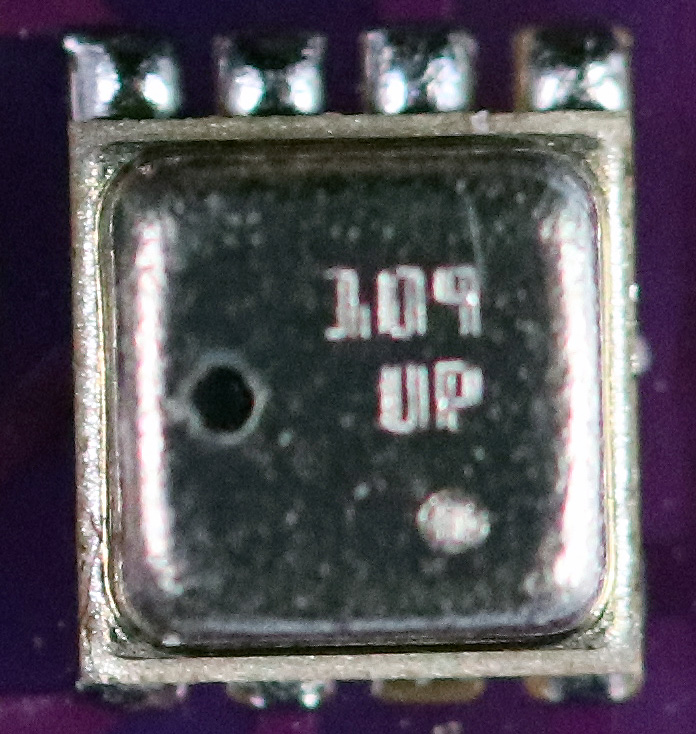

Looking closely at the BME280E, you can see the markings 109 and UP.
121023
Looking again at this site, which I mentioned previously, that UP marking is the only one to indicate a BME while there are many others signifying a BMP. That has now been my experience as well.

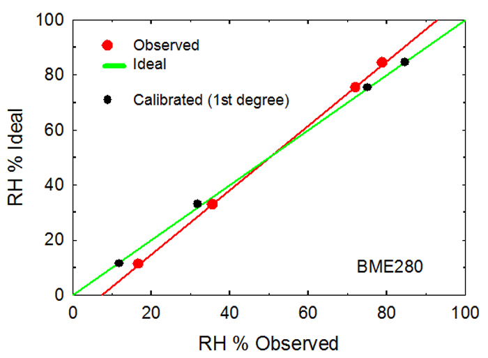

Decided to evaluate the humidity sensor on the BME280 (using NaCl, MgCl, LiCl and KCl) . It could have been much better as I observed up to a +/-5.5% error (calculated an average error of 8.86%), but calibration in software is easy enough to do and seems reasonable in this case.
At least its linear and repeatable.
