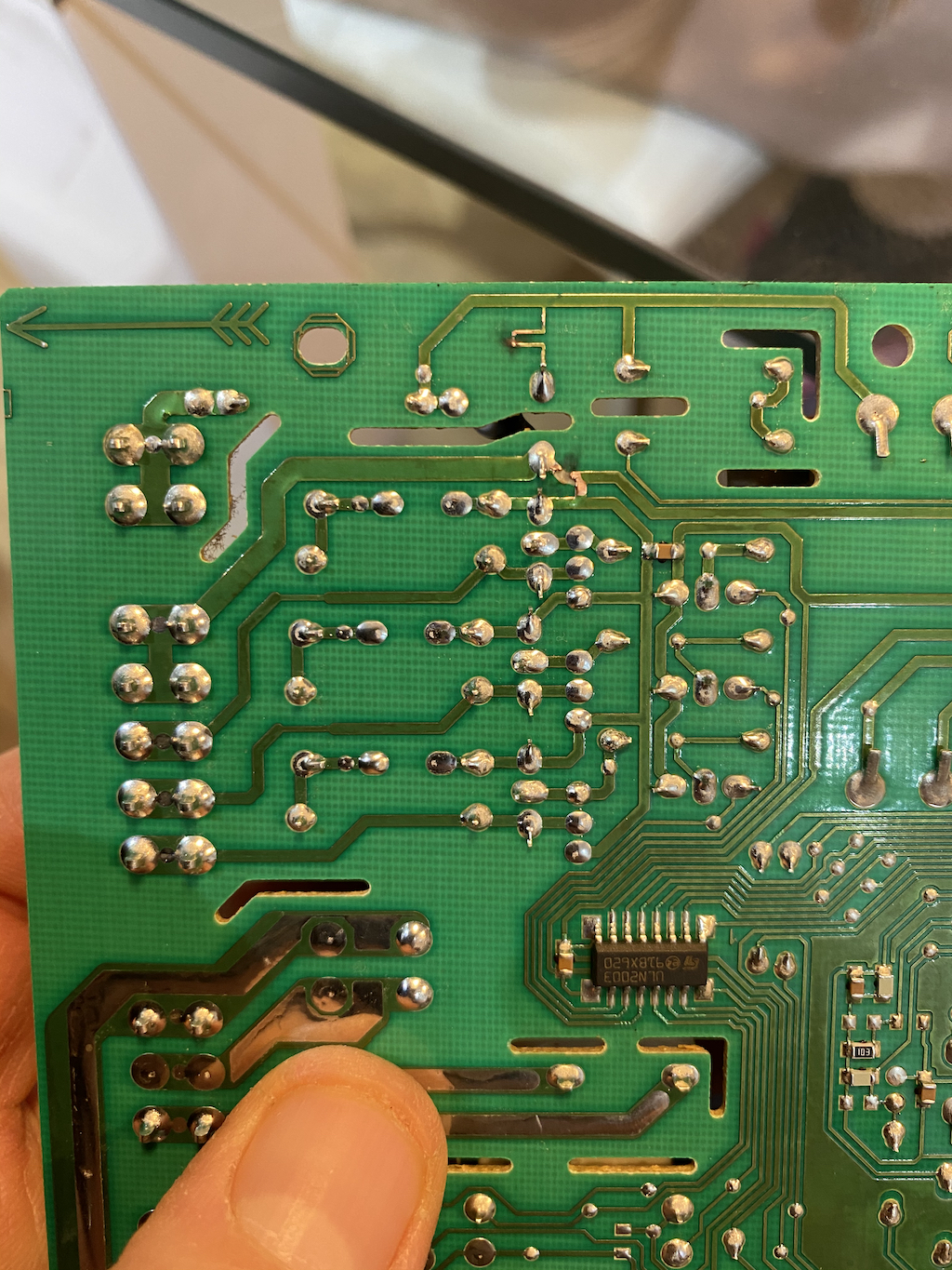

That is a catastrophic failure. If the wires blew off this side of the board, what to the copper traces look like on the other side of the board?

To be fair I think the tracks look ok... (attached photo)
Is there anyway of testing the tranny? Like continuity across specific pins? And if so, would you know what pins? There is 8 pins labeled 1-8.

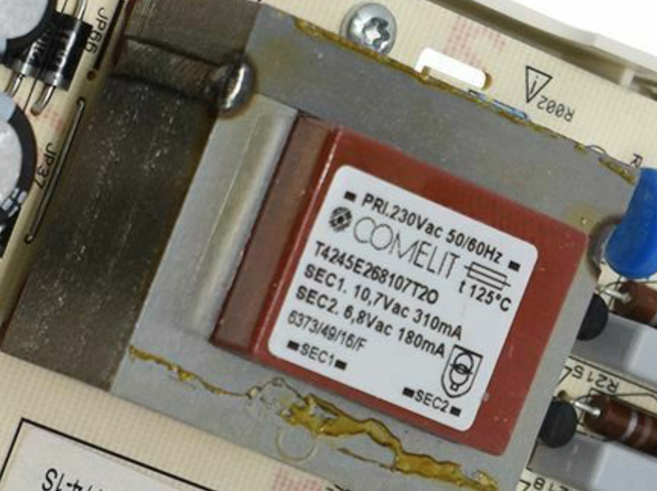

Just found a replacement board for £100. I know its not much, but wondered what the chances are of getting the components and doing it myself. Attached a photo of the board I found zoomed in on the transformer for ID. Whats the chances of finding one of these do you think?
That looks like an entirely different (and MUCH older) board.
You won't be able to source parts for the board, because it's a custom board with a custom switch-mode transformer, the service procedure is to replace the entire board.
